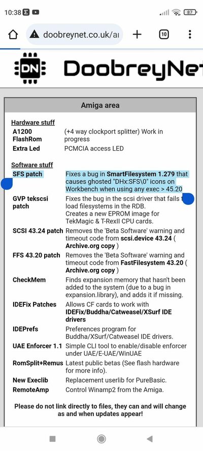

After finding a reliable hard drive, I want to use Smart File System. It works but this icon remains on the workbench screen as you can see on the image and the INFO command gives this result.

Thanks for the reply. Kickstart is version 3.2, workbench is version 3.9. I tried both with and without updating scsi.device. Initially the hard drive had FFS with 2 fully functional partitions obtained using HDToolBox and fully formatted. They installed on RDB SFS v1.277 and fully formatted FDH1 (formerly working partitions). It works very well but the icon remains and the info command gives the disk unreadable but it works. I tried removing sfs from RDB and reusing FFS and the strange icon disappears. After a fresh install of SFS and a full format of the partitions, it never changed, the icon is still here. I have had SFS for over 10 years in my other A4000 and this problem is new to me. As you say, it never has corrupted or corrupted files or partitions. The only difference is the kickstart rom, one A4000 has v3.1, the others have v3.2.2.
Thanks to an AmiBay user, it seems that the problem has been solved, as you can see in this image.
I'll try this afternoon.
