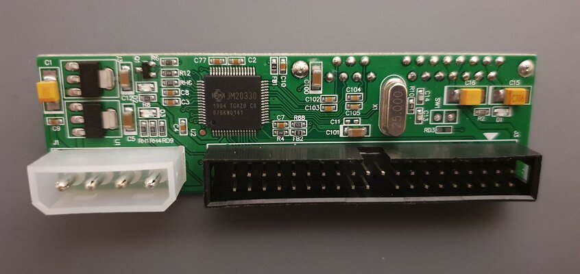

Adapter in question:

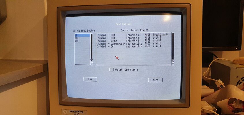

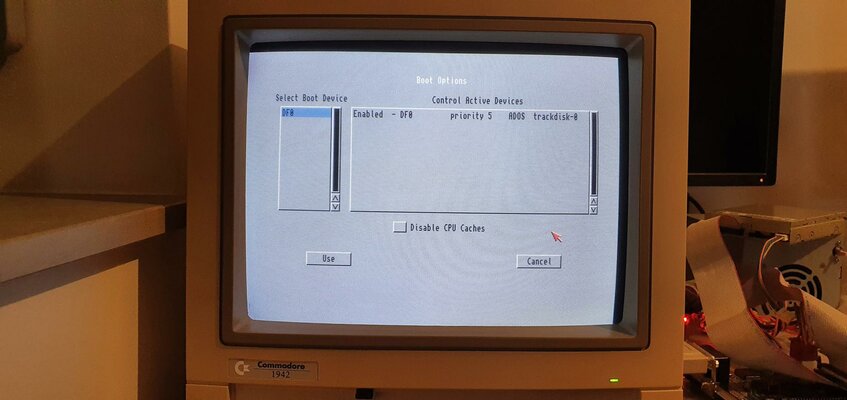

When two SATA hard drives are connected to the internal IDE connector on A4000D, both using this identical adapter at least, no hard drives are visible:

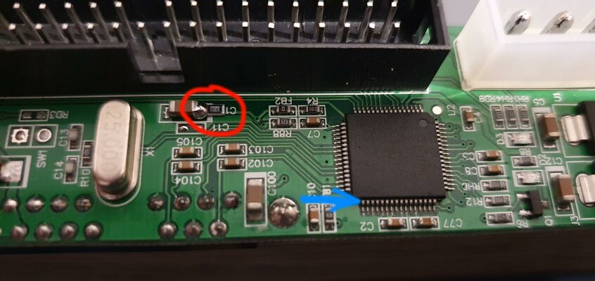

Consulting the JM20330 datasheet reveals pin 33 could have been used for master/slave selection.
Unfortunately, on these boards this pin is tied to the ground (pulled low).
To modify the adapter to act as a slave we need to pull pin 33 high.

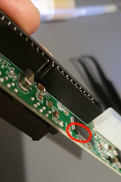

What you need to do is lift pin 33 from the pad (blue arrow in the 1st pic, red circle in the 2nd) so it is no longer connected to ground and solder a 1k resistor to a suitable 3.3V spot (in my case capacitor C101, red circle in the 1st pic):
Next, connect the lifted pin with the resistor, effectively pulling the pin high:
You might want to be extra careful not to break off the pin as it's a really tiny and fragile bit.
I broke it of course, so I had to file a bit of plastic off the chip

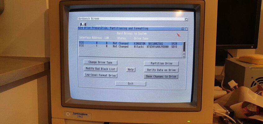

Anyway, after the mod, lo and behold, both drives do get recognized and work properly:
