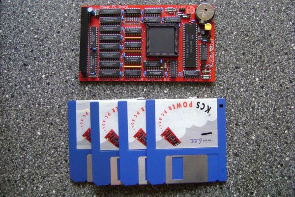

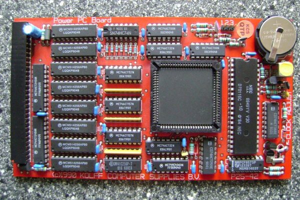

For sale is this KCS Power PC Board. Later revision V2 (P25.42) and supports harddrives & floppy drives. Install, utilities & MS-DOS v6.22 disks are included. New coin-battery holder (+ 2032 battery) installed for the RTC.
This card can also be used as 512Kb Chip RAM for A500 or 1MB Chip RAM for A500+.

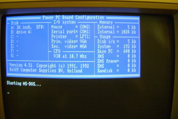

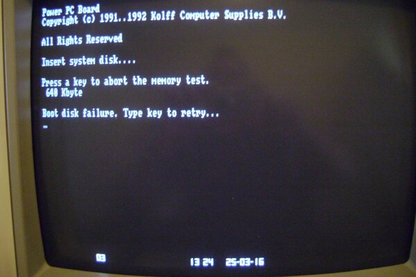

The card is tested en works 100%.
Techn. info:
A500:
Connects to the trapdoor connector
Zorro II (A2000):
The same A500 version is connected to a Zorro II adapter card
Power PC Board v2:
  • NEC V30 @ 10 MHz processor
  • supports HD controllers but a special driver is necessary
  • software revision 2.90 supports the following HD controllers: A.L.F. (OMTI), A590 (OMTI, SCSI), Golem HD3000 (OMTI), Profex HD3000 (OMTI), Winner I (OMTI), F.S.E. (OMTI), Rex Datentechnik (OMTI), SupraDrive 500XP (SCSI), GVP A500+ (SCSI)
  • much faster video emulation (CGA)
  • revision 2 boards can be identified by board label "P25-42"
1 MB RAM:
  • 704 kB free RAM in MGA/CGA mode
  • 640 kB free RAM in EGA/VGA mode
  • 200 kB extra memory for a reset proof MS-DOS RAM disk
  • the RAM can be used by the Amiga as 512 kB Fast RAM and an additional 512 kB RAM disk
  • the board can use the Amiga's Fast RAM (up to 8 MB) as PC memory
  • does not multitask with the Amiga
  • uses the Amiga internal serial port with up to 19200 bit/s
  • uses the Amiga floppy controller and parallel port
video:
  • up to 640×480 in 16 colours
  • MGA 720×348
  • CGA 640/320×200
  • software emulated flicker-fixer in any PC interlace mode
  • battery backed up clock
  • emulated PC sound card
  • not compatible with NTSC Amigas
I'm asking €40,- + shipping for this nice piece of Amiga hardware. Banktransfer (IBAN/BIC) only.
