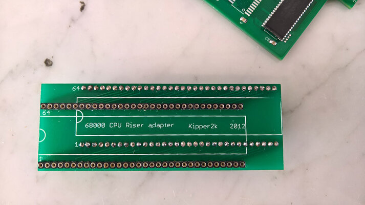

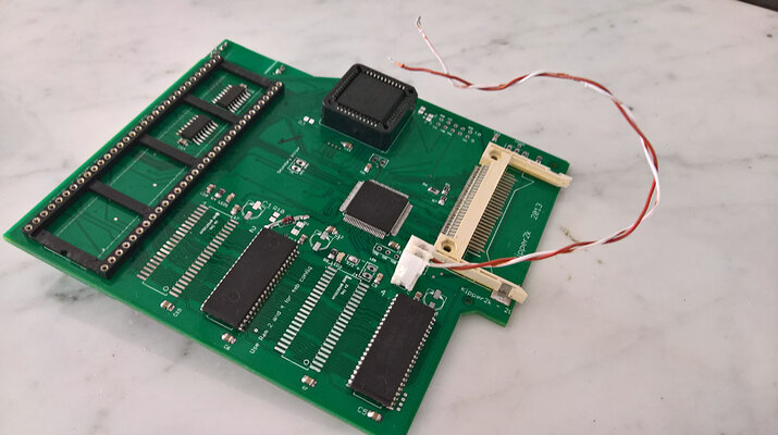

Not sure if it's going to help, but I was able to find this picture
It's not the best resolution but...

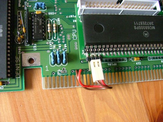

It should be on pins 9 and 10, when counting from top. With my board I went different route and soldered this connector to PCI connector header that I had. So now I can just plug it into any A500 board.
it uses the same two spots that the MKL 68K IDE interface uses.
/OVR and /INT2 are available on the top side of the 86-position card-edge. Number one is a ground contact, and so is the next one beside it. In older A500 mainboards (rev5) these two positions may form a big unified copper area. When counting the top side positions, /OVR is the 9th, and /INT2 the 10th. In "pin-numbers": /ovr = pin 17, /int2 = pin 19, /int6 = pin 22. Link "Google" for other finds of information.
