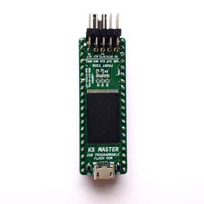

Selling a few USB Programmable 1MB ROMs I recently designed. They're a good replacement not only for Kickstart ROMs, but for pretty much all kinds of 40 pin 8/16bit ROMs
It's not visible from the pictures but of course they have rounded pins to avoid damaging the socket

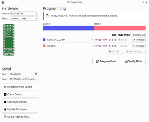

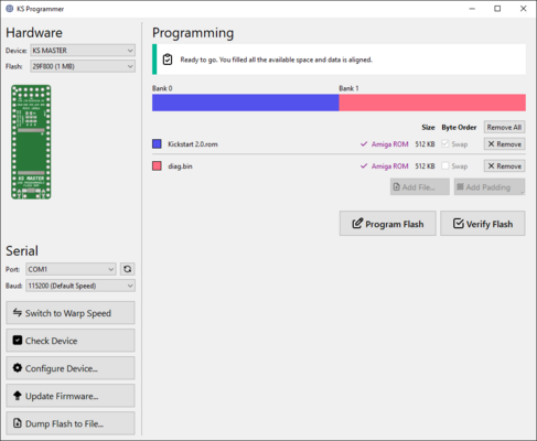

The KS MASTER can be easily programmed by connecting it to a PC via USB with a Micro USB cable and using the "KS Programmer" software

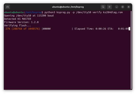

The software is written in Python and it works on Windows, Mac and Linux. If you're experienced you can also use it from the command line, it's quite "hackable" since communication with the board is done over serial.
Running on Windows:
Running on Linux:

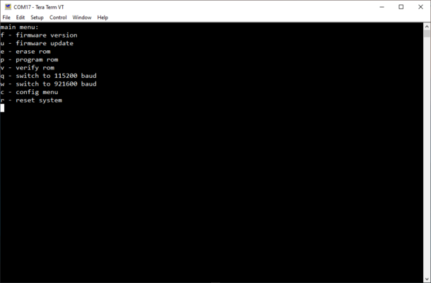

Command Line:

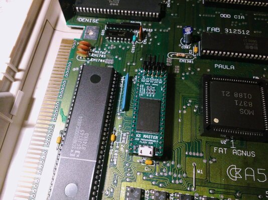

Finally here's a picture of a KS MASTER in my Amiga 500
I later routed a short micro USB extension cable through the expansion port so now I canmess with my ROM burn different Kickstart versions and mods from the outside, without making any permanent change to the original case!

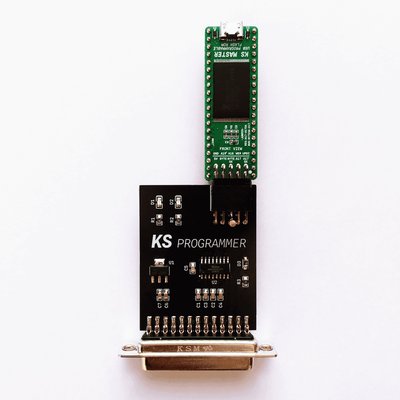

I also created a small module to program these roms from an Amiga instead of a PC. It plugs into the serial port and you can connect a KS MASTER like this:
Of course this is completely optional, programming with a PC using the USB port it's still the fastest and most convenient way, it's just nice to be able to use an Amiga to make roms for another Amiga

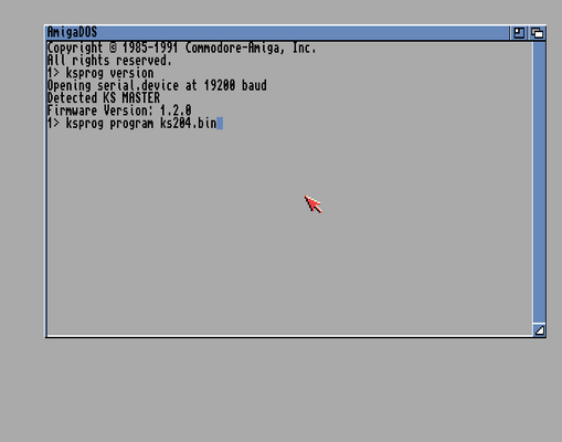

The Amiga version of the software is really basic, it has no GUI at the moment, you just run it from the shell and with 2 simple commands you can erase and program the rom from a binary file
