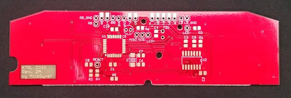

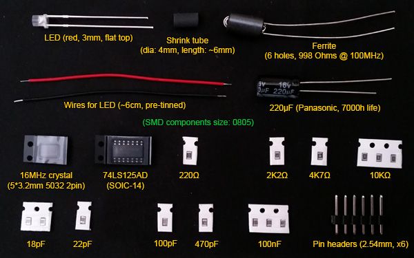

I'm confused about the parts... If you look at your page, you state you need 220µF electrolytic cap 16V for c5. But if you look at the diagram, it shows c5 is 47uf. So does the pdf here. So are you shipping 47uf or 220uf cap? I also noticed a few other components in the html don't match the pdf of the schematic.
It doesn't really matter. I ship with a 220uF normally, anything between 47uF and 220uF is fine, it's there for more reliable power.
Ok. cool. What about c4 and c3? they were 100pf and 22pf, but the pdf shows 1000pf and 100pf now. Same thing?
