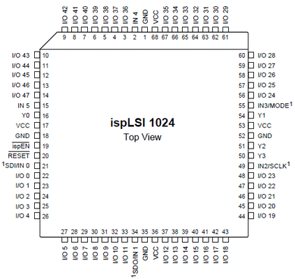

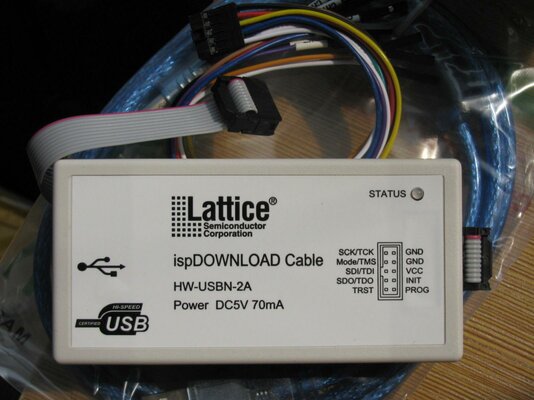

Guys I bought this to program the ISP Lattice chip. But which connections should I use. You see, so far I have soldered a 68 pin PLCC socket to the proto board and connected all the VCC together and GND too. But not sure about the others to the chip. Can someone use the pic to mark the connections please..
Thx...

Other than the power and ground, you'll need to connect these pins between the programmer and the ispLSI1024 chip:
Programmer <-> chip
SCK/TMS <-> IN2/SCLK (pin 49)
Mode/TMS <-> IN3/MODE (pin 55)
SDI/TDI <-> SDI/IN0 (pin 21)
SDO/TDO <-> SDO/IN1 (pin 34)
You'll also need to connect ISPEN_ (pin 19) of the chip to GND.
PS
Please note that this programmer would support the "ispLSI1024", but not the older variants "pLSI1024" or "LSI1024".
Thanks so much. But one question, why would the ISPEN go to GND. Should it go to PROG on the programmer instead..

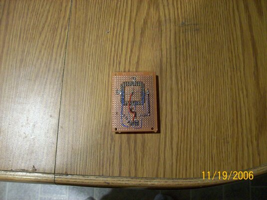

Update.
Here's my Lattice program adapter that I've remade, and it looks nice and tidy now. Plus has a 3 pin header now, so I can connect the isp-en to the GND (on the chip) or the prog (on the programmer) That way I can find which connection works by changing the jumper....
