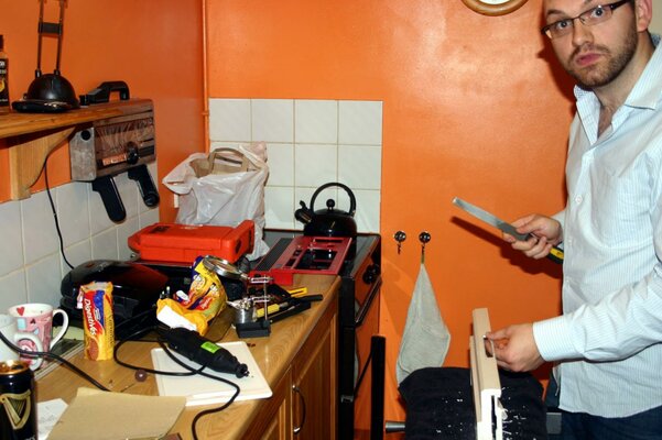

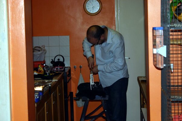

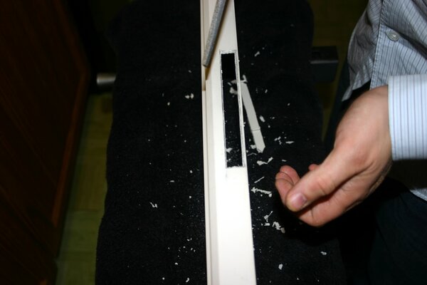

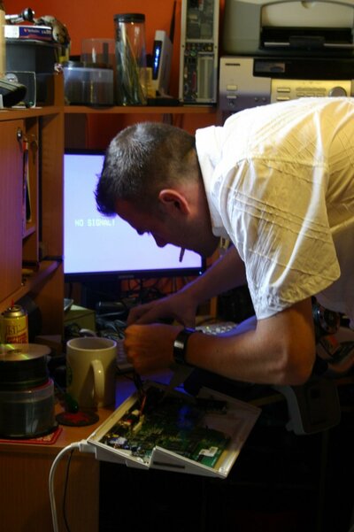

Me and me mucka having a beer and hackery evening!

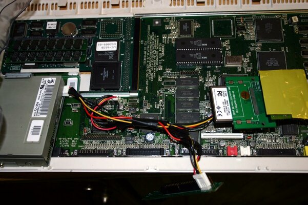

As i see you planting a cd-romplayer in it. I want to do the same whit my A1200. I got there a question, how do you connect the unit to the mainboard? Just whit a 40pin split master and slave or do you use some splitter?

hi,
we used a Teac 224E cd drive with a JAE to ide 3.5 adaptor, this is connected to a buffered IDE interface, and running IDEFix software to sort out the channels.
If you like the Ferrari A1200 there are more pictures in my photo albums on my profile page.
cheers, JuvUK
