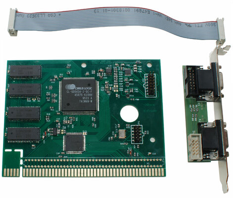

Guy's.. My Matzes a1k.org Graphics Adapter arrived.. But I was wondering what the other connector is for (JP1)....
OK... Though But what's the white connector for on the other board...Because I though that it goes to the Commodore A2320 card that's in my 2000...
Also if I'm using Picasso96 WB how does Amiga games switch to normal mode...
Ok.. So do I connect that port to JP1 on the card to X2 then.. Because both have 10 pins..But the card didn't come with the ribbon cable...
Oh, or do I just connect a VGA cable from X2 to Commodore A2320. I don't want to sound stupid... You see
Connect NOTHING to JP1!! The Matze graphics card is like other picasso II out there...
The lower db15 connects to the scandoubler and the upper db15 to the monitor!
