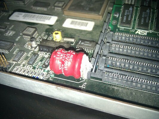

Hi guys.
I picked up a fairly dinged up A4000 desktop a while ago with some battery leakage.

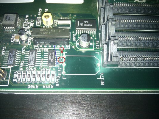

I got the battery out and noticed there was a track missing...the computer works fine. Did the whole lemon juice, toothbrush and running water-routine....still fine.
Why does it still work, and what is the purpose of this former connection?

An educated guess but I'd say that if the A4000 operates ok with the missing track, then the track is probably the one going from battery to either RTC or ground.

Last time i've repaired an 4000D that chip controls both mouse and joystick port, have you tested both mouse buttons and joystick movements?
That missing/damaged track is part of the RTC circuitry. In this state, the RTC is not recognized by the system. Even after mounting a new battery.
