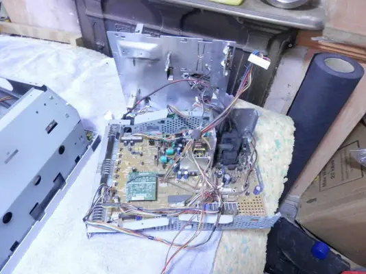

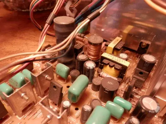

been a while so this needs updating

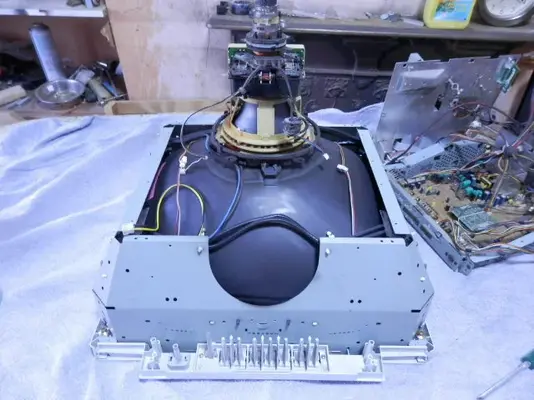

this is a iiyama mf - 8617e
would turn off after 3 seconds,that was a power supply fault,couldnt find any bad caps,so changed the two switching ic's this uses 3842 chips
then it stays turned on but wouldnt lock to any signal as a primary source from my crappy laptop,strange fault,wipped the settings and turned off the power saving function,and it started to work
theory from me is power started to go and currupted the firmware a bit
luckilly i programmed two new eeproms and now it works no problem
annoying thing about this,is you cant use the menu without a signal source,that can be a real problem if tyour trying to wipe settings to make it stay on

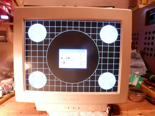

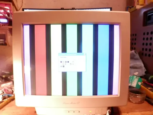

pictures for the picture fiends,to show it works,only one left now,and thats what the thread was about originaly
