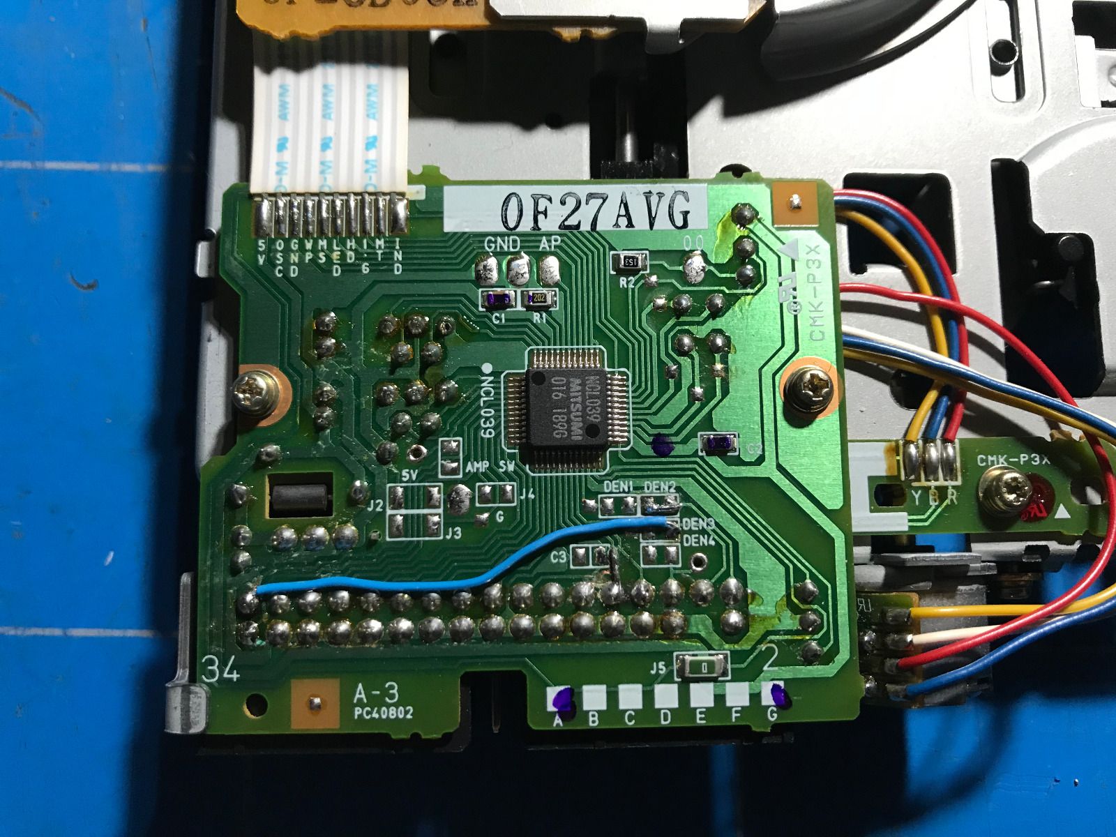

I got a couple of Mitsumi D359M3 drives I'd like to mod for my A600.
I tried to read various guides but I think I misunderstood something.
Which guide should I follow? Will this work in my A600?
Thanks mate.
I tried to follow this guide but I have no READY signal on Sys Test. I'll try to mod it following this guide, which is similar to the one I linked before.
EDIT: found that the solder MT was broken. I did it again, I'll test it tonight
