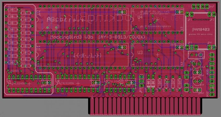

I wonder if I might ask a favour? I'm still very much feeling my way in the old PCB design business. Among my happy surprises is my managing to make a functioning Mockingboard clone - a dual AY-3-8913 based sound card for the Apple II.

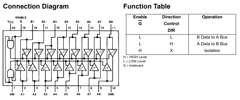

I'm using two 74LS245 IC's to isolate the Mockingbird electronics from the Apple II bus. In essence think of these as a gate for data flow:
-On or off
-In or out
...toggled by to lines, see truth table from the datasheet:
I did have both IC's connected to the same bus lines, set up for A->B transmission (ie IN). The IC feeding the Mockingboard side on by default (toggle line low) and the COVOX side off by default (same toggle line routed though an inverter - 7404). Flip the bit and the two '245 ICs will flip operation: Mockingbird off, COVOX on - hurrah!
You may have already seen the issue: Both '245 IC's are set for A->B (Apple bus to card NOT the other way round) So I can pump all the sound I want down the COVOX 'ADC' but the data will never appear on the bus - Bum!

What if I rewire the COVOX '245 so that instead of A->B and ON or OFF I set if to A->B or B->A and always on..? So now if the control line is low (0) we have Mockingboard mode ON and COVOX receiving. If the control line is high (1) that switches off the Mockingboard side as before and switches the COVOX side to transmit.

-I'm fairly sure I've gotten the logic on the '245 ICs right for the above plan but when you're going round in your head: "If /DEVSEL is low then the Mockingboard '245 is transmitting and the COVOX '254 is receiving, but when /DEVSEL is high the Mockingboard '245 is off and the COVOX '245 is transmitting"... and then you keep saying that while looking at the '245 datasheet truth table with one eye and the Mockingbird schematic with the other. Doubt, and possibly madness, can start to creep in.

If anyone feels a great rush of kindness would they mind doing a sanity check for me?
-Is the above plan sound?
-Have I actually got my '245s wired up right?
-Does my output circuitry look robust enough for the sound coming out of the AY chips not to go strait down the COVOX input so causing the AY's to reprogram themselves with their own output?
