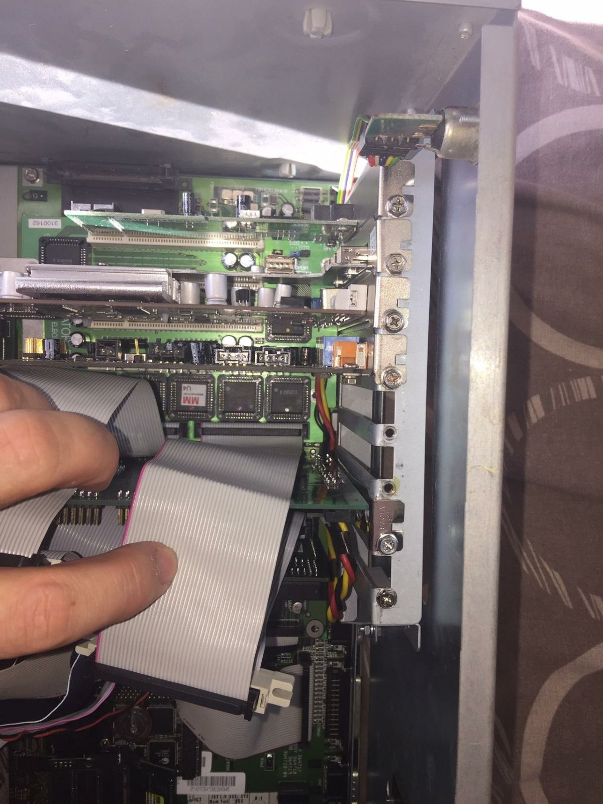

Also I adjusted my back-plate so the cards would fit properly too, I'll get photos of it also when I do measurements.
So first the back plate....
It’s not much of a mod all I did was use nuts has spacers between the Case and the backplate bringing it inline with the PCI and Zorro cards when fitted
So cards look like this when fitted

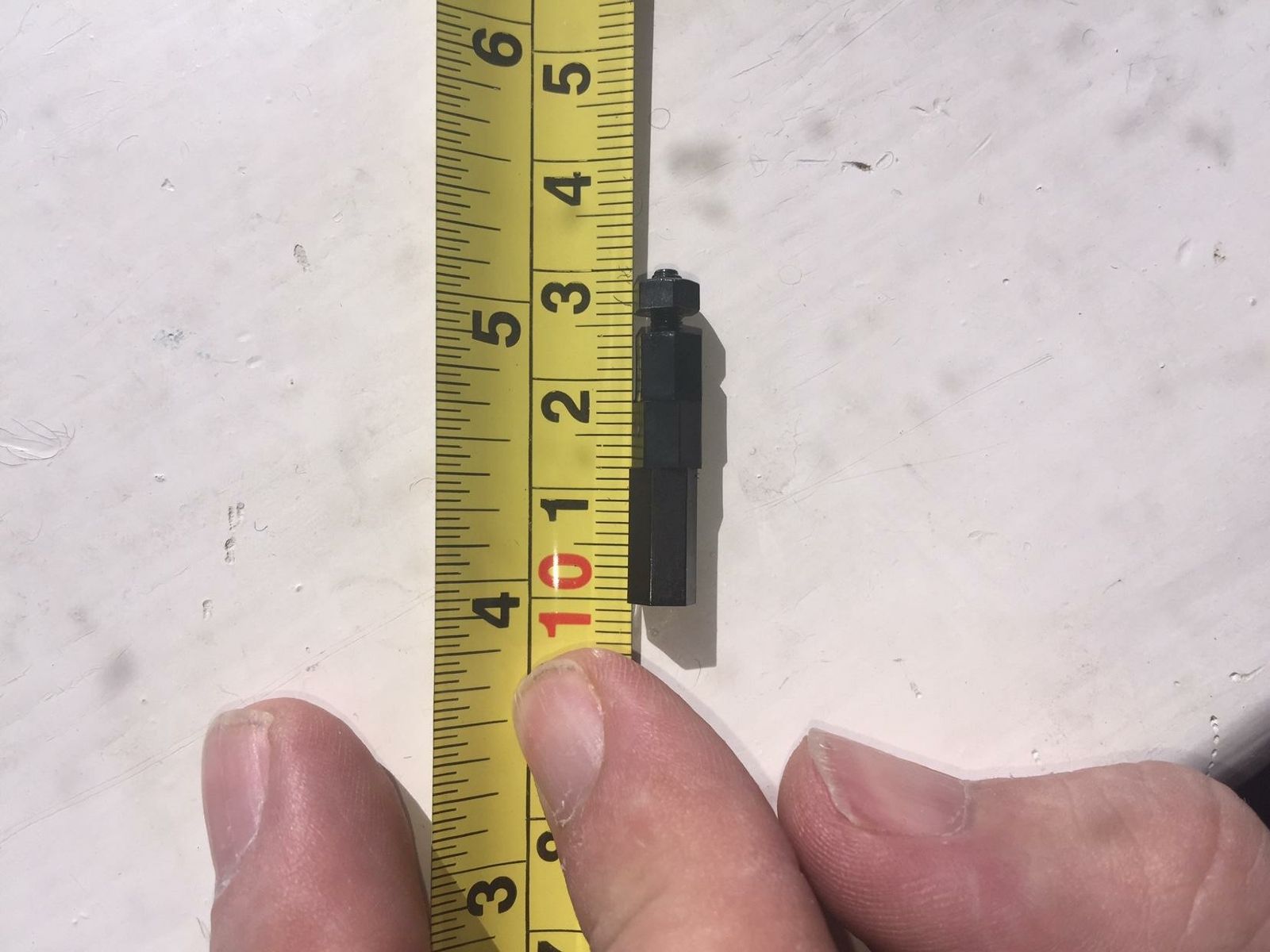

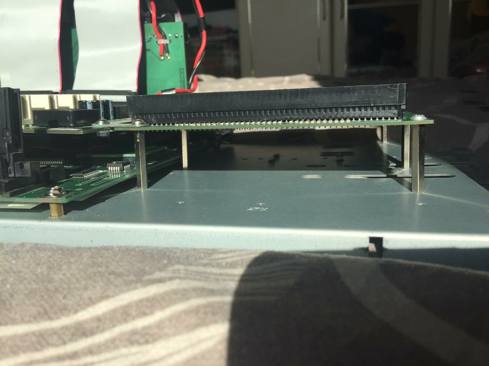

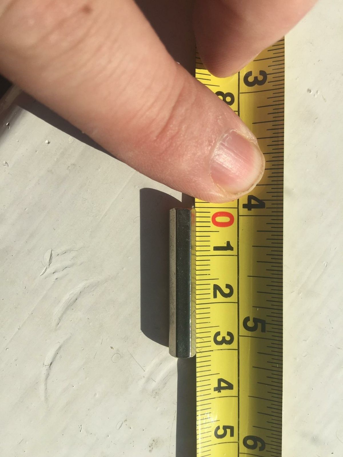

Now for the Elbox Zorro ZIV busboard mountings.

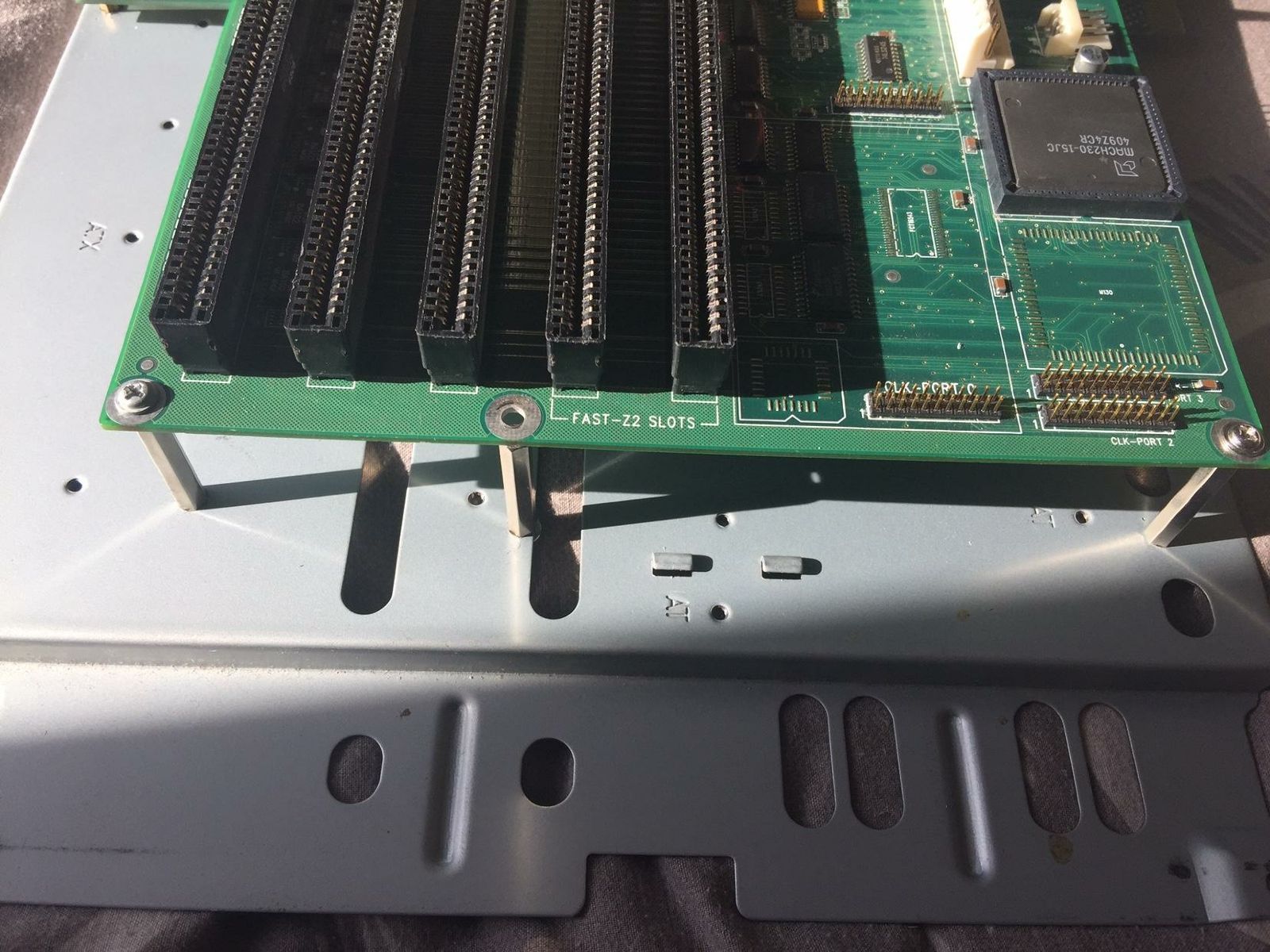

So there are 5 metal stand-offs which measure 30mm in length.

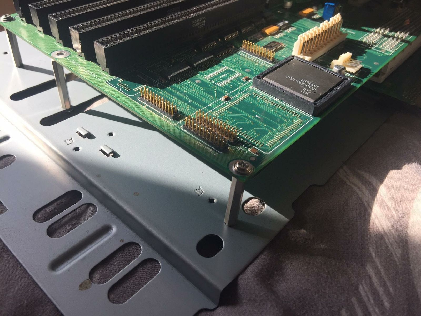

4 of mine are holding the busboard securely in place (marked in red) with the fifth just being an extra middle support due to it being out of alignment (marked in yellow).

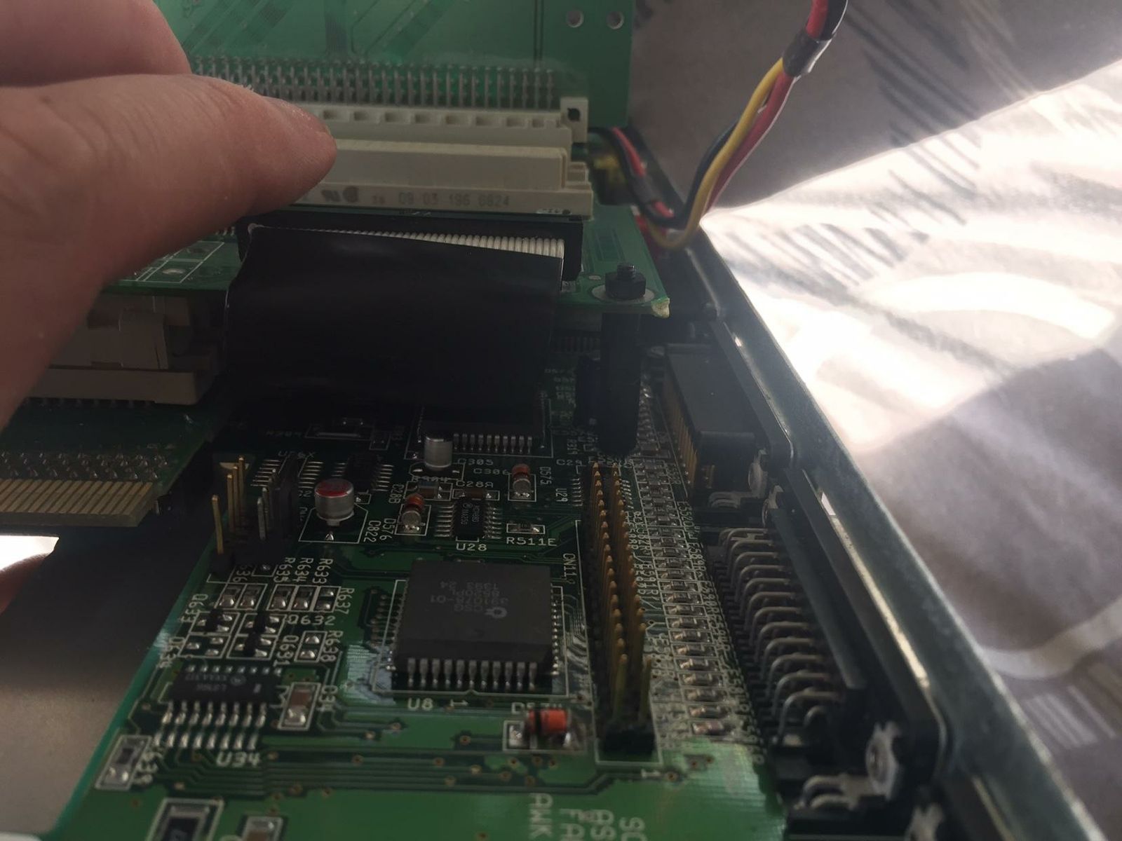

Now I forgot that I also made this plastic leg to rest on the motherboard near the video slot enabler header

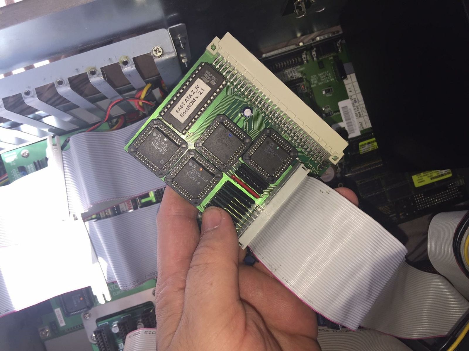

Here are some more images of all the supports
You can see the busboard rests on the Elbox Keyboard adaptor this end

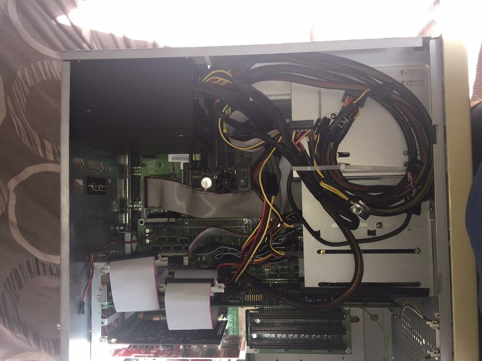

here is the system back to its former glory
