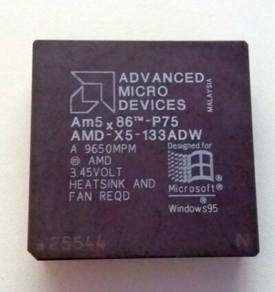

My first 486 from a few years ago. Thanks to parts found on AmiBay I'm going to give that machine an upgrade, to bring it closer to Pentium speed.
Have one overdrive and one DX5 133MHz chips in the mail that can potentially run with the motherboard, but won't know until they get here. Want to benchmark them against the current DX2-66.
Back in the 90's didn't have a 486, so I didn't know much about their motherboards. I did accumulate a few CPU's. Then when I got a 5V socket 3 I tried some CPU's and probably fried my 3.3V AMD's in the process. I did not know that DX4 series had a different voltage. Potential casualties are 2x 100MHz and 1x 120MHz AMD chips. Though there was no abnormal behavior. No chip overheating. No smoke. So maybe the CPU's or the board have protection against incompatible hardware. Either that, or they fried so silently, that I didn't even notice.
Does anyone know if inserting 3.3-3.45V CPU into a 5V socket kills it or if power is delivered via different pins, offering some kind of idiot protection. My board behaves as if it recognizes the wrong CPU type and refuses to power on entirely. Maybe it's a good sign. On DX2-66 and slower chips it runs fine.

With a socket adapter I'll run through my DX4 chips and find out once and for all if they're dead or not, and will stick with whatever ends up being fastest.

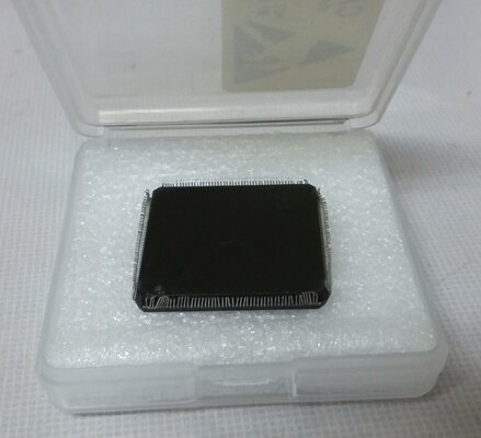

I went ahead and ordered an SMD CPU replacement and a voltage regulator for Gainbery. I hope by the time they get here I can find proper schematic explaining what solder bridges were doing on CPU pins.

Next I'll be testing AMD and Cyrix DX4 chips in about 2 weeks and then DX5 some time in December. Hopefully I can find some combination of gear that can lift this machine above 66MHz. I'm asking myself - what if the chip the board came with never worked with it to begin with? What if that CPU was fine all along and my board wasn't right for it. Guess I'll never know.

So far got 2 chips in the mail a lot sooner than I expected. First one the seller didn't secure it correctly and it ended up banging up all its legs, making SMD replacement on a Gainbery next to impossible. I am more likely to buy form a different source, than to take chances with this one, as it's not easy to test pins for connectivity, with traces mostly hiding beneath the chip. The The other CPU is essentially the same thing, but will require a socket adapter and a heatsink. I also found a Cyrix 100GP lying around. I heard it's as fast as the 133MHz AMD. Can't wait to test it. I also found one proper Opti chipset Socket 3 motherboard with VLB in the same position, but I'll wait on it till I'm done with Matsonic M601.
