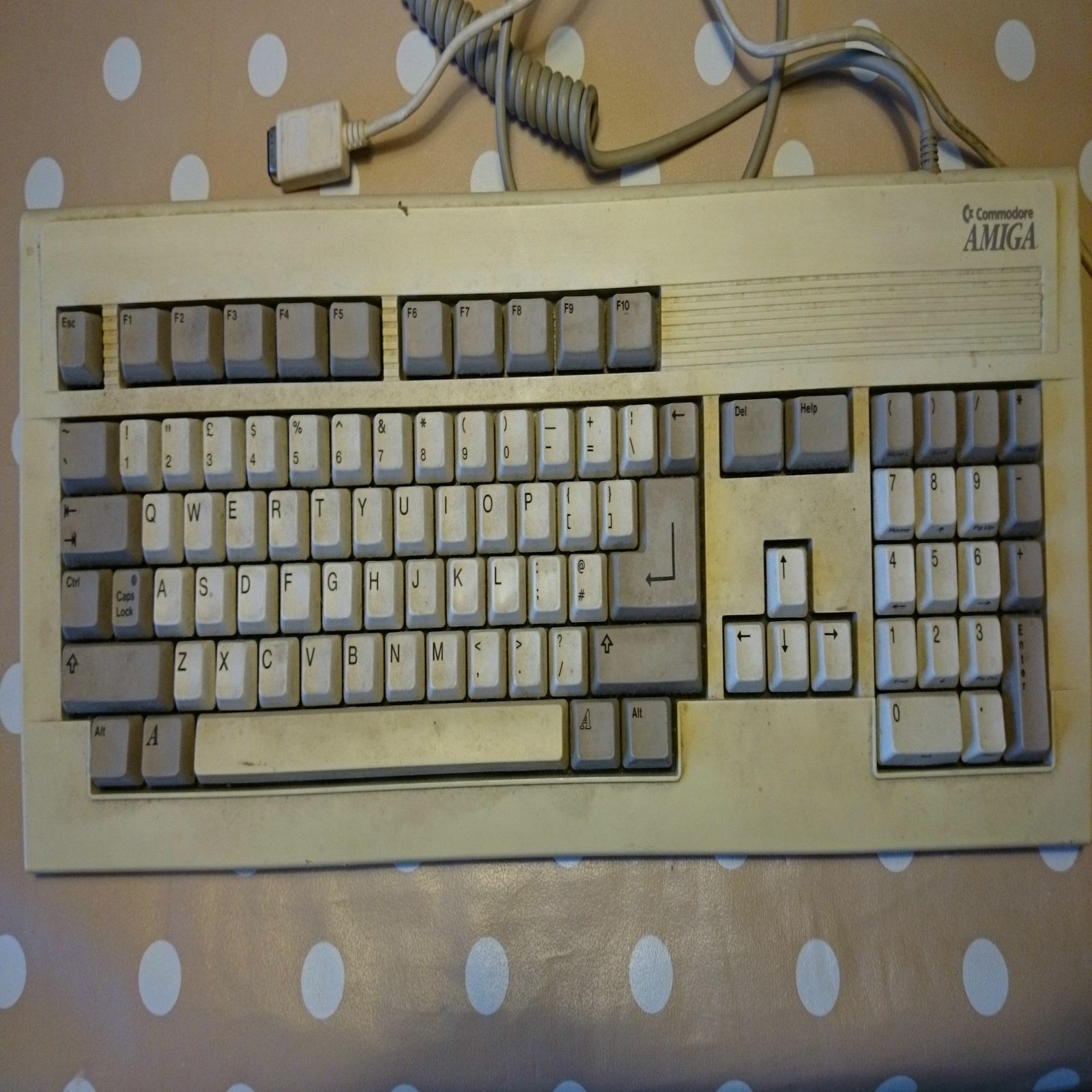

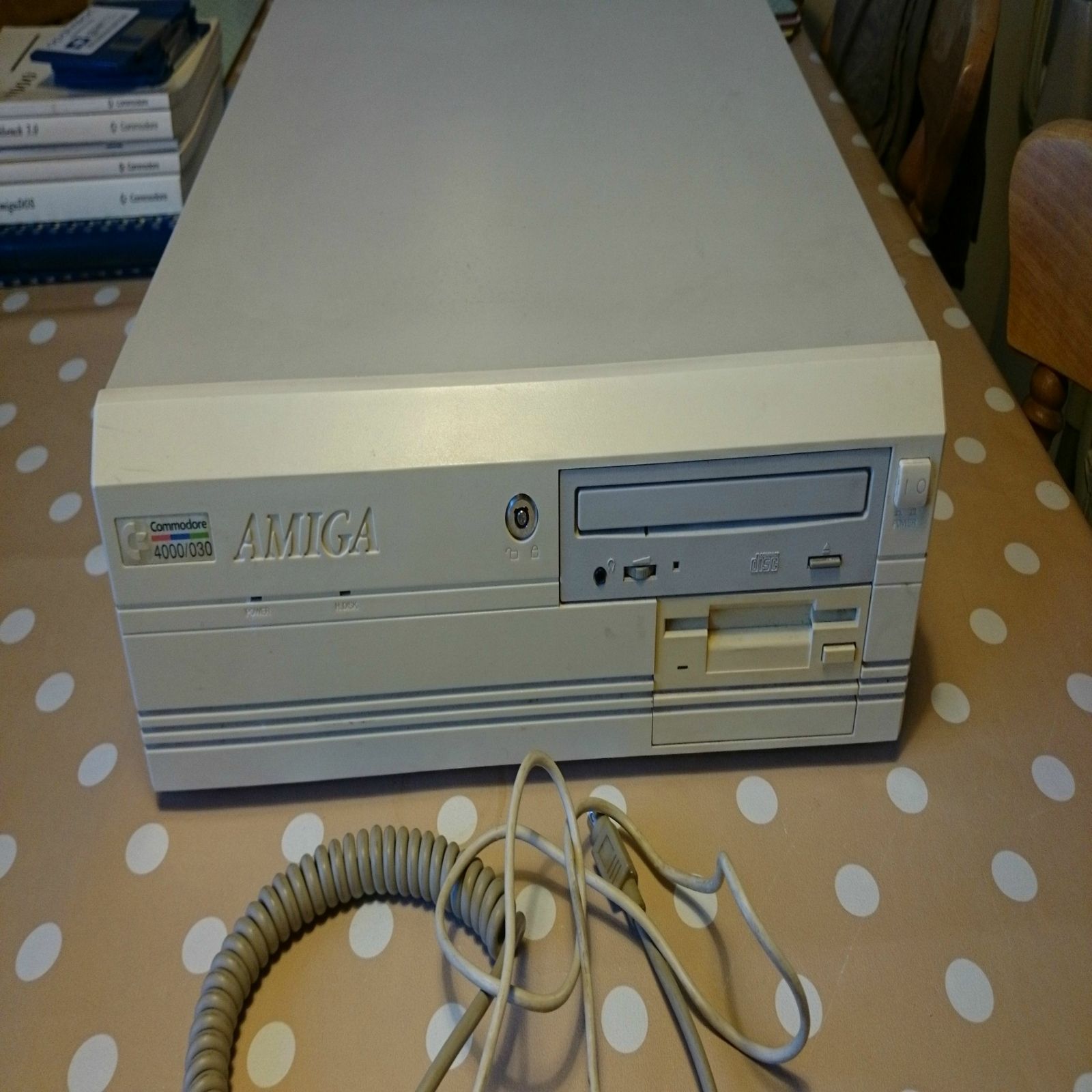

Hi just thought I would share a few pictures and ask a couple of questions related to my A4000 restoration. I have wanted a 4000 for over 20 years to I am taking my time with it to get it just how I want.
As I found her when I got her home after collecting, I was lucky as although the seller lived a long way from me he had a relative just a few miles down the road from me, I was really pleased with the price and feel it was fair for both of us.
Gruby and yellow.

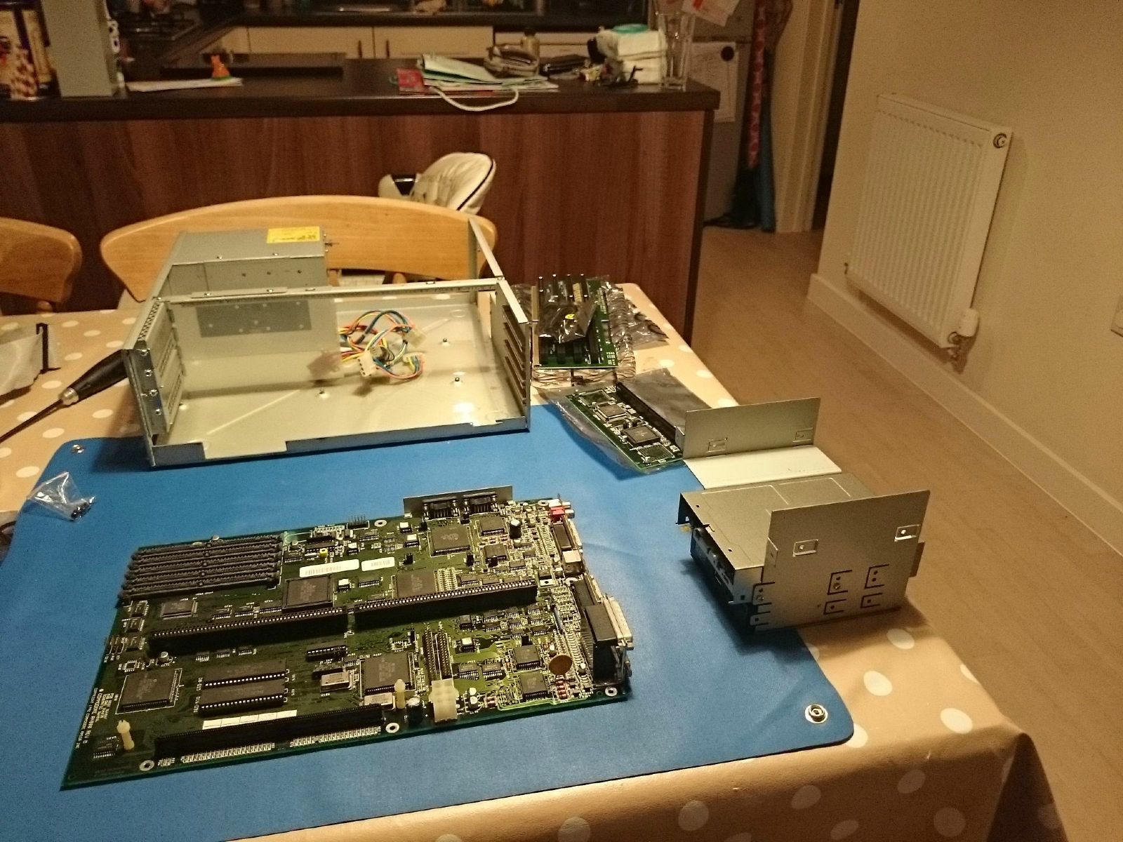

I had asked for pictures of the battery area before buying and it looked to have some mild greening but as the machine was booting I decided to take a punt. I quickly completley dismantled her to access the damage.
Battery snipped off, plenty of green I will post pictures later but luckily a good treatment with lemon juice and then de-ionised water has removed all of it.
The platics (inlcuding keyboard were so yellowed I decided to paint with Tamiya TS spreay.

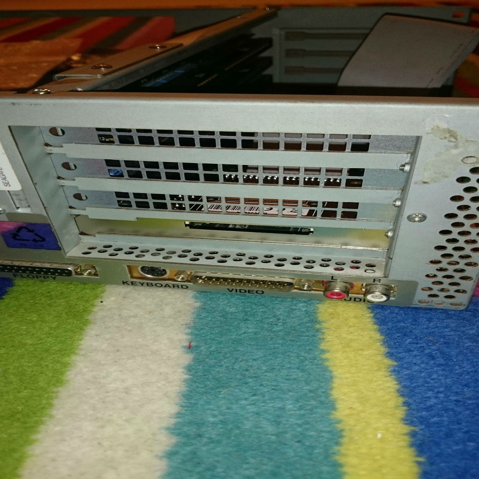

The fan noise was hideous so I upgraded fan to a silent one and modified the grill.
I added some more venting for better airflow.

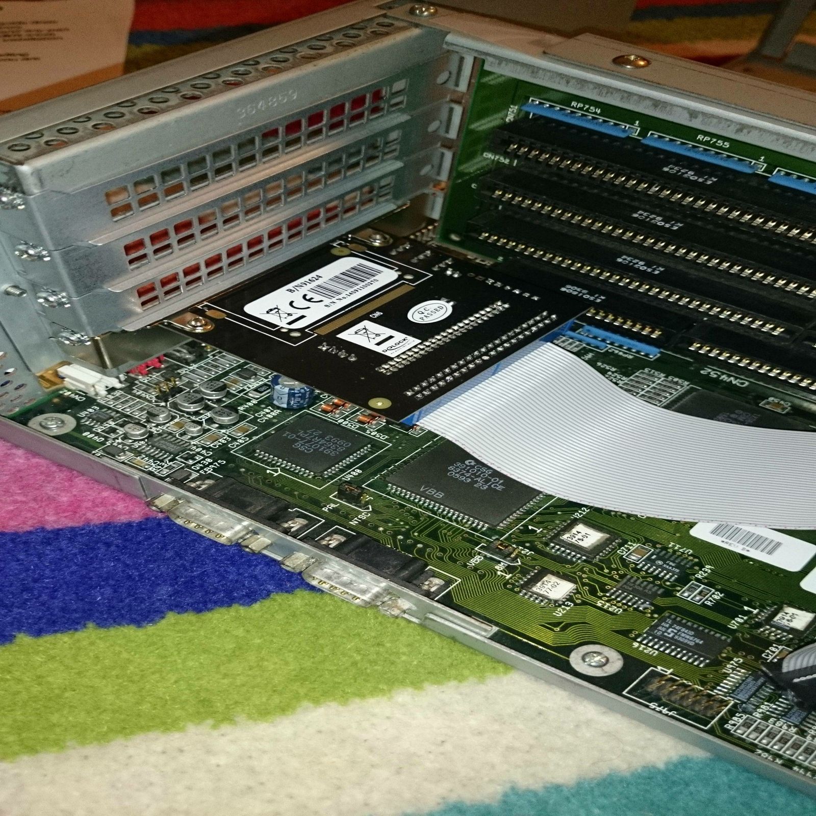

Added a compact flash HD with Classicworkbench Full until I get a RTG card

All cleaned ready for rebuild.

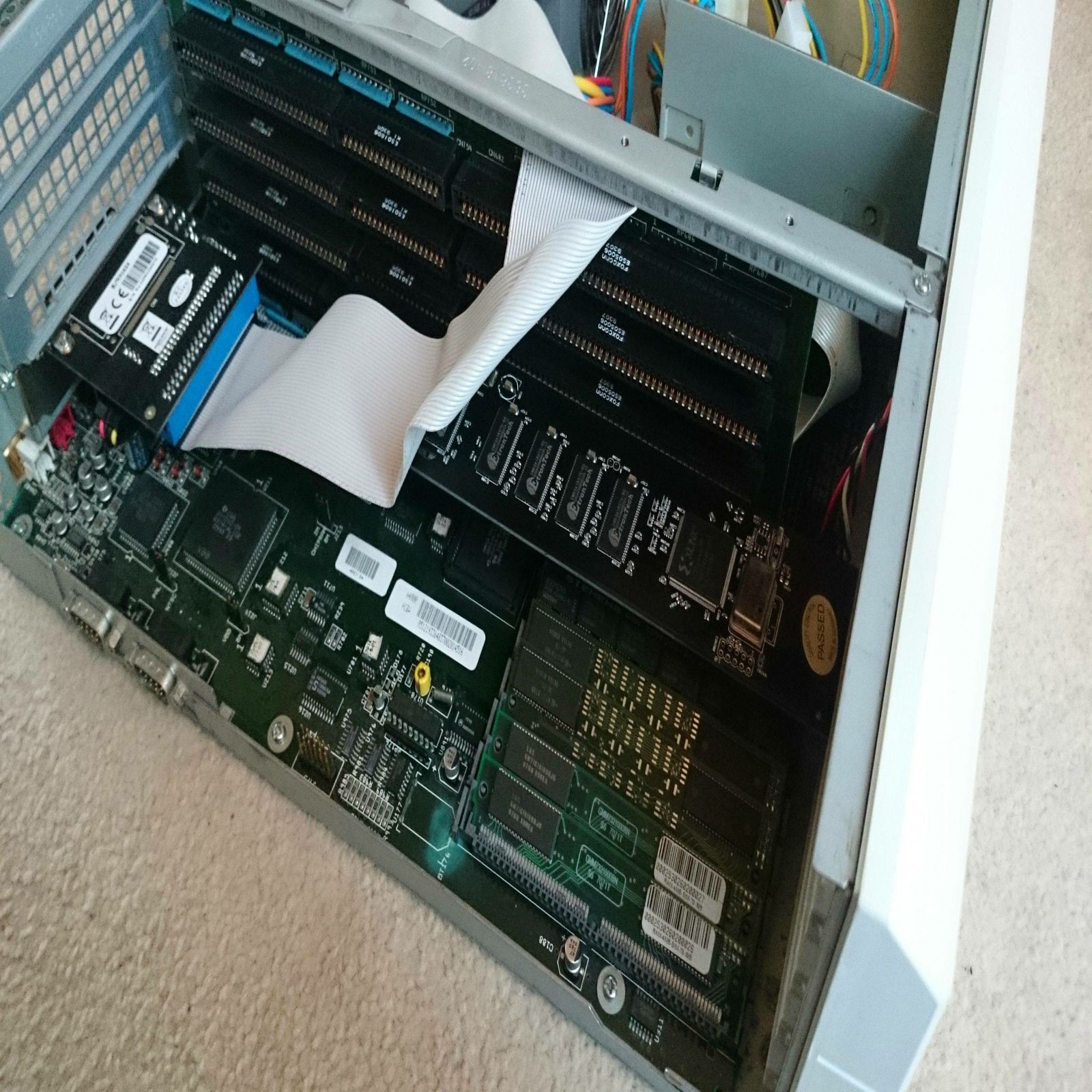

Added a big ram plus
I will take and add photos of the finished paint and motherboard work tomorrow, next to add is a A3640 3.2 CPU card and a Xsurf 100. Then a RTG card.

As promissed some after shots, im pleased with how the paint came out, it looks as though the drive bay is a different shade here but its just how the photo has come out.
Keyboard came out ok, I just need to retrobrite the logo now when we get some sun.

Xsurf installed
And big ram plus
