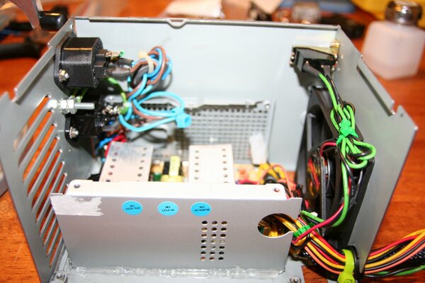

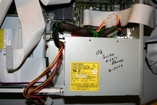

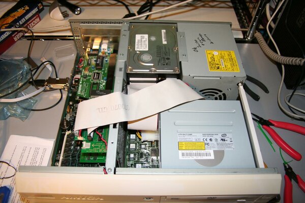

I finally got around to working on my A4000D ATX mod today and it turned out great! I really want to thank Nathan for sending me the dead A4000D power supply that allowed me to do this mod. :)
Here's what I used:
Dead A4000D Power Supply
Blue Star 325W mATX PSU
AmigaKit Amiga A4000 ATX PSU Adapter Cable with Switch

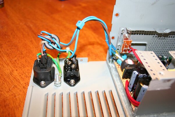

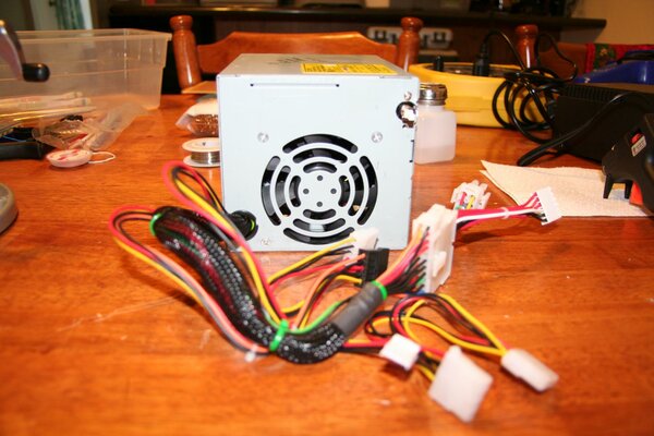

Nathan had already gutted the A4000D power supply so all that was left was the case with the wires attached and a fan. I removed the power switch from the dead power supply and cut all the unnecessary wires. I cut the wires to the pass-through monitor power connector because I'm not going to use it. Finally, I removed the old fan.

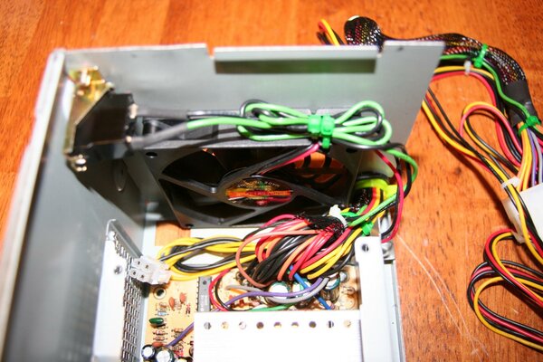

Next I disconnected the fan and removed the top of the case from the ATX Power supply. I cut the wires from the power connector then completely removed the connector. I was able to then place the ATX Power supply sideways into the old PSU case. Then I attached the ATX fan to the old PSU case and re-routed the wires through the old case.
I used hot glue to hold the ATX PSU in the old case and I was also able to run the switch from the ATX adapter back into the old PSU case and attach it to the correct location so the power button rod would fit just like the original.
Finally, I soldered the wires from the old PSU's power connectors to the wires I cut from the ATX PSU's power connector and used heat shrink tubing to finish up. It took a few hours total but I think it turned out great for my first ever try at this.

Wow! Thank you all for the wonderful words. :) I sincerely appreciate your thoughts. You are my peers in the retro community and I really value your opinions.
I had a few goals in mind when I was doing this mod:
  • Make the mod completely removable by not modifying the A4000D case.
  • Keep the hard drive tray in the same location.
  • Use the original A4000D power rod to turn the power on/off.
  • Keep things as tidy as possible.
The dead A4000D PSU that Nathan sent to me made all of these things possible. My biggest concern was how I was going to attach the ATX PSU to the inside of the old PSU. I decided to use hot glue and it worked better than I expected. :)
