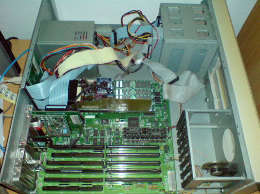

Well sort of. :) I no longer have the 3640 to use it and I'm going to send my CyberstormPPC to Stachu this week (probably just the flashrom after not being turned on for 10 years..)
A friend is going to lend me his 3630 so that I can use my A4000T meanwhile.
Here are some photos of the mainboard:
The backplate of the Audio Video module is lost at the moment.
Also the vertical drive bay is lost but I don't think I'll every be able to find a replacement so I'll find another way to mount drives there.

I plugged in some cards for preparation.
What do you think about the order of the cards?
1: Zorram (I guess it will be useful at the moment since I'll be using 3630 for a while)
2: Empty
3: XSurf100
4: Toccata
5: Empty
6: Emtpy
These are the cards I have: CyberstormPPC, CVisionPPC, Toccata, VLabMotion, Peggy+, Zorram256, XSurf100

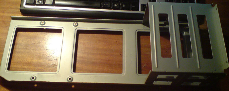

Unfortunately I have only one of these:
I'll need two more of them which were lost with that huge bay.

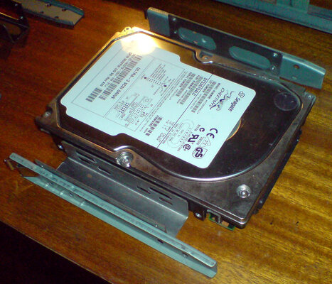

I think yours is floppy holder without the front plastic. For the disks I got three pairs of these:
Then disk is mounted like this:
Here is photo of the internal metal plate which I dont use because it colides with CSPPC and CVPPC. But I miss two vertical 5.25" places then.
Without the internal metal plate there is a lot of space inside.

That huge internal metal plate is the part (3rd picture you posted) that was lost. I took it out because mine too was colliding with something (probably CVisionPPC)
I have the floppy drive holder on the top, and the cdrom holder under it. The only harddrive holder I have is under the cdrom.
OK. Maybe Escom changed some of the equipment during the production time. My A4000T seems to be some of the first wave, because original battery was the same like in A4000 Destops (that little leaking barrel). Anyway A4000T was always my dream and I fully understand you want your machine to be complete and in original shape as much as possible.

You can mix them how do you like, base on their sizes, better cooling, optimal connector output.
It turns out that I can not mix them how I like.
I tried several configurations and this is the one which worked:
First slot empty at the moment
Second slot: ZorRAM256 Zorro3
Third Slot: XSurf100 Zorro3 Mode
Fourth Slot: VLab Motion
Fifth Slot: Toccata
EDIT: (Actually it could be the opposite of this because I plugged the Zorro3 cards on the upper slots thinking they are the first slots. It turns out that the bottom slot is the first slot (because it's address space is lower?)
I guess the first card have to be Zorro3 cards because as soon I plug a Zorro3 card between two Zorro2 cards, it either won't see the cards or (with some other configuration) I get a defective message upon first powerup.
