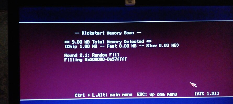

Now here is an issue i have with Zorro Bus!
This is 8 Mb ram card it works on my A500 plus and 4000D with no issues but when i put it into this A2000 it comes up with errors! but only on Amiga test kit software!
I have clean card, re flowed all Zorro sockets just in case of cold joint and tried all 5 Zorro slots and same result error. and i have change the jumper on card to 4mb and same result!
However I Have notice when I first switch Amiga on with or without Zorro card installed I get a green screen flash for like half second then it's gone and boots fine. (not same green screen as if you have chip ram error, it's a darker green screen)
I booted to workbench and filled up ram disk with floppy disks to make memory full to see if Amiga crashes from that error in Amiga test Kit, But no it didn't crash it filled memory up and was working fine no issues! as you can see in photo! which is weird that it works in workbench without any issues!
then I put in DiagRom and did Ram test on that with all 5 Zorro slots that had taken a while to do but no Issues there either!
So if anyone has an idea on why It has a green screen on power up only (warm boot is fine) and why Amiga test kit showing error on fast ram, then any feedback would be great!

Here is an update on what i have found out with my Amiga 2000 issue!
First i bought myself original Amiga 2000 rev 6.2 motherboard to compare it to my Amiga 2000 motherboard base on rev 6.2
here is original Amiga 2000 with my kickstart 3.1 ROM and 8mb Zorro Ram card
I did full test on Amiga test kit and as you can see no issues with ram!
Then did same test on same motherboard with Bluster this time not Buster!
As you can see it comes back as errors on Ram Card! Bluster is rev b so now I know it bluster is the issue not My Amiga 2000 motherboard!
This is my Amiga 2000 motherboard that I assembled and with buster (from the original Amiga 2000 )
As you can see no issues with ram card So it 100% bluster issue but i have no way of reprogramming it at the moment!
The screen green issue i mention from first posted is Denise issue as i have move my Denise from My Amiga 2000 to Original Amiga 2000 and same issue green screen when first power on, and i have tried the Original Denise from Original Amiga 2000 in my Amiga 2000 and fully working with no screen screen on power on, so my Amiga 2000 is fully working just a issue with Denise and Bluster chips, which i need to look into!

But if only go back to just Zorro II fast ram card then the error comes back, So i now know it's a DMA issues with bluster and Amigakit Zorro II Fast ram card.
But not really an issue if you have more then one Zorro Card installed, So i am classing this Amiga fully working now!
little update, I have now replace Denise with super Denise and i don't get screen screen when power on
2nd thing i have done is replace bluster with buster and i don't get any ram issues now.
