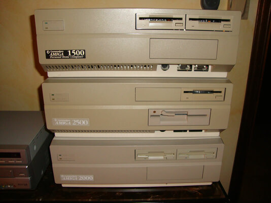

I've got three Amiga 2000, to be precise, an A2000, A2500 and A1500.
My project is:
- use A2500 with original configuration and expand it only with original Commodore boards;
- use A2000 with third parts boards expansions for better performances;
- use A1500 for an original 68000/1.3 ROM/WB 1.3 environment and compatibility.

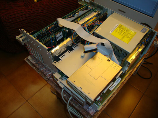

So here is my A2000's config:
1) Amiga 2500 (it is original, not re-built with A2000 parts)
- Motherboard rev 6.4
- Original ROM 2.0 (original A2500 configuration)
- Commodore A2630 with 68030 CPU at 25 MHz, 68882 FPU, 4MB RAM (original A2500 configuration)
- Commodore A2091 with 100 MB HD with installed AOS 2.04, 2MB RAM (original A2500 configuration)
- Commodore A2320 flicker fixer
- Commodore A2065 ethernet board
- Commodore A2286 PC emulator (with 5,25'' PC floppy drive, 1MB RAM, 80286 CPU, 80287 co-processor)

2) Amiga 2000

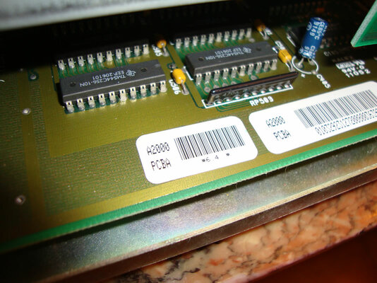

- Motherboard rev 6.3
- Original ROM 1.3
- Kick ROM switch with ROM 3.1
- GVP G-Force 030 with 68030 CPU at 40 MHz. 68882 FPU, 16MB RAM
- GVP Impact 2000 HC+8 with 1,3 GB HD with installed AOS 3.1, 4MB di RAM
- Macro System DeInterlaceCard flicker Fixer (in A2000 video slot)
- Village Tronic Picasso II RTG Card with 2MB RAM
- Ariadne II ethernet board
- Second Floppy unit DF1

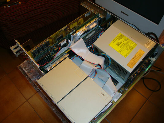

3) Amiga 1500 (it is original, not re-built with A2000 parts)
- Motherboard rev 6.2
- Original ROM 1.3
- Commodore A2630 with 68030 CPU at 25 MHz, 68882 FPU, 4MB RAM (at boot i can choose to use original 68000 without RAM expansion for more compatibility)
- GVP Impact 2000 HC+8 with 50 MB HD with installed AOS 1.3, 4MB di RAM
- Commodore Genlock A2300
- Second Floppy unit DF1 (original A1500 configuration)

At the end, for sure i want to follow your suggestion about 2MB chip RAM... i have some gaps, but... how i can upgrade chip RAM? Have I to swap a FAT AGNUS chip?

As for the 2mb Chip Ram mod, you need a Revision 6.x motherboard, which you have. You then need to de-solder and remove the 8 x ram chips on the motherboard. You then install 4 sockets and populated them with 1mbx4 (from memory) DRam dips (very cheap and easy to get). You then replace the Agnus with the correct revision 2mb version (be careful, only SOME revision 2mb Agnus work, some have different pin outs!), put in a single resistor (47 ohm from memory) and two wire links and you are done! Its actually quite a simple mod as long as you are reasonable at soldering and have a decent de-soldering gun.
