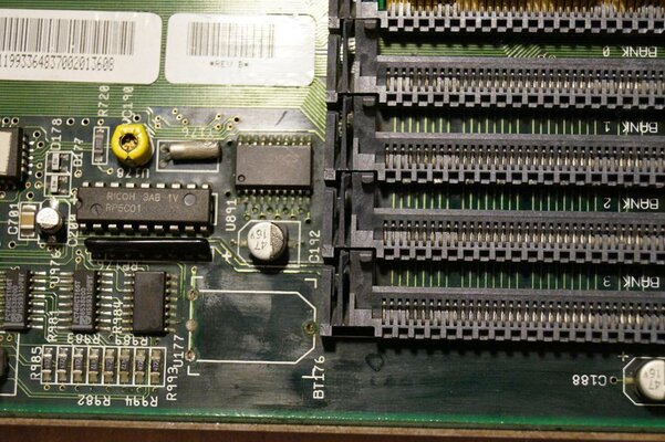

Ok I think my Amiga 4000 is about to die. I don't want to say farewell to my second beloved Amiga, so here are the faults and I want your help please.
My A4000 has 2mb ram, hard drive Seagate 1275mb and 3.1 roms. The only added thing is a Individual scandoubler and a dvd rom drive.
First of all a pin in the motherboard IDE connector was broken. Well I replaced it and the IDE hard drive worked fine. That's the only good thing in the story.
From the first time I bought the A4000 (about 10 years now) and still after the broken pin, it has this issue. When I press the power button for the first time in the day, the 4000 powers up but it shows this error message (see below).
After 10 to 15 tries of resetting and power on/off then finally it boots normally from the IDE hard drive. Now after the first succeeded boot (probably when the 4000 warms up), no matter how many times I power off and on the 4000, the error message is not showing and the hard drive boots normally. I made a test with a 4gb CF IDE card and it shows the same issue. Could this be the board capacitors or something that I can fix?

Here is a photo from the 2gb ram.
and here some photos from the configuration

Am I missing something here....your photos shows more than 2Mb ram on the board? (at the very least it has 6Mb, up to 18mb...as shown in the photo)
If I understand that correctly, your software errors may be related to the system not picking up the entire ram installed?
If you pull out the lower 4 memory simms, do the problems still occur?

Sorry if I'm stating the obvious, but as it hasn't already been mentioned, I'll just mention it...
You have 5 slots on the A4000 motherboard and the TOP one is for the Chip RAM only - this must be populated. If you are only showing 2mb and no Fast RAM is appearing, then you may well have problems with the slots or bad tracks leading to them (as I had...).

Hi,
they are the correct settings - 8MB of Chip RAM (the alternative settings on those jumpers) was never implemented - 2MB is the maximum.
Think there was a jumper elsewhere (852?) that selects between 1MB SIMMS and 2/4 MB ones - that could be set incorrectly..?
You are correct, there is a jumper J852 almost below daughterboard and near ram slots. It is set to 1Mx32 simm size.
Has the board got any green fuzz on any of the chips around where the battery was....or any black looking traces in the same area?
U891 chip pins are little green. But not too much green as it looks in the photograph. I can upload a highest resolution of 5456x3632 if you wish. Original battery was removed by me 10 years ago. It was never leaked unless there was a previous leaked battery a very long time ago. Though Y176 seems corroded.
Doesn't look too good, does it? Nearly all of the connections in that area look corroded, and not shiny at all. Even the capacitor on the right looks like that too!
And what's the deal with that 'barrel' shaped component - it looks like it's been covered in something highly corrosive to me... :(
