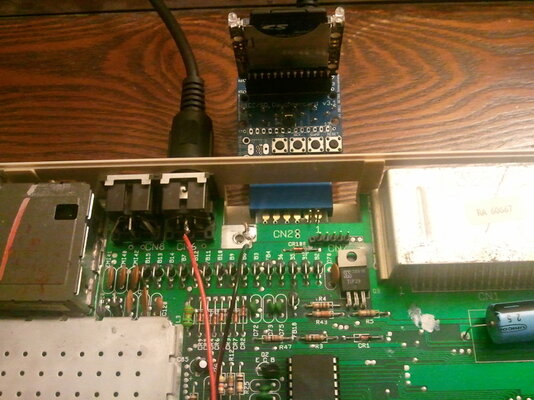

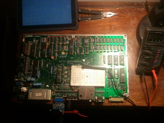

First up was to test the internal connections vs. the external uIEC/SD and map everything out:
attachment.php
Near the back I found a nice spot where most of the serial lines connected except for the reset pin which I wired directly to the back of the serial connector. Using a few pins donated from an old PC motherboard I went to work soldering them into place:
attachment.php
Here you can see the original uIEC/SD external daughterboard attachment used to validate the connections:
attachment.php

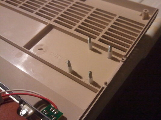

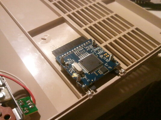

Then I found a nice spot on the upper portion of the case on the left side that the uIEC/SD fit nicely into and made a few stand-offs out of screws and plastic pipe to space it appropriately. Notches were carefully carved out for the SD slot and lights:
attachment.php

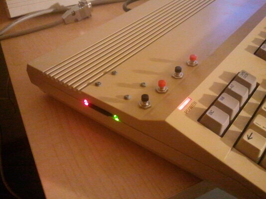

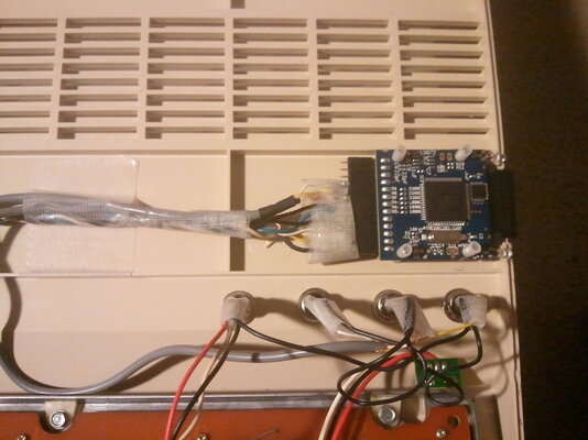

Next I soldered up the pin header to some old CD-ROM audio cables (which fit the spacing of the pin blocks created earlier nicely) and carefully taped up any exposed solder joints and between leads. Also I created holes for the 4 push-button switches that were also wired up to the pin header:
attachment.php

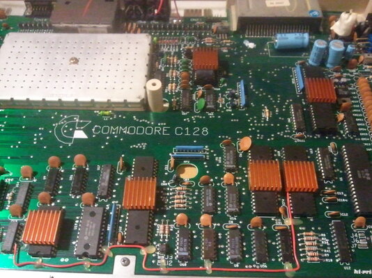

And then before putting it all back together, getting rid of the useless "heat shield" and it's contact fins which cause more problems than they solve and replacing with a more modern heat-sink solution to the areas it was intended to assist with (using the excellent 3M double-sided thermal stickies):

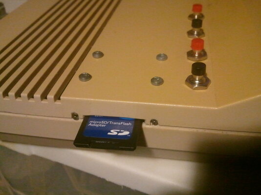

Finally it was time to connect up the headers and close up the case to see how well the SD cut-outs worked. It came out just the right depth for popping in and out easily and is extremely solid:
attachment.php

Nice :thumbsup: really love the 128 sd mode, If I come across 4 bevelled screws I`ll send them to you, I might even paint the tops off white ;)
That's the one aspect I compromised on as the only screws I could find nearby that fit the uIEC/SD holes firmly and easily threaded the stand-off pipes were those tiny wood screws; I'll have to double check the size and length next time I have it open because having it match the case would be great :)
