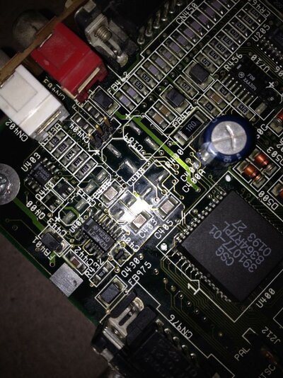

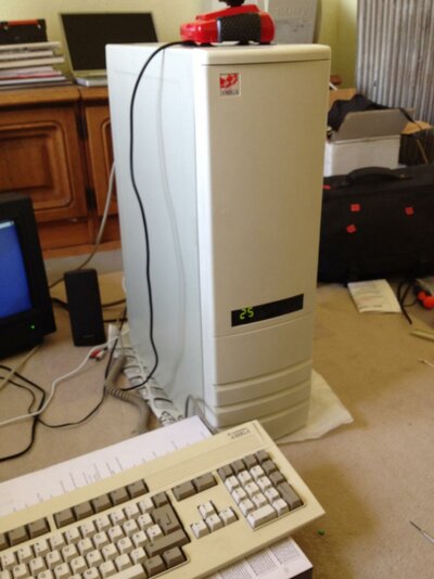

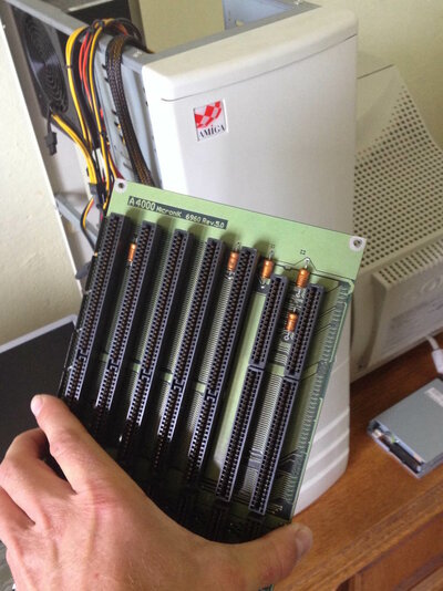

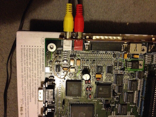

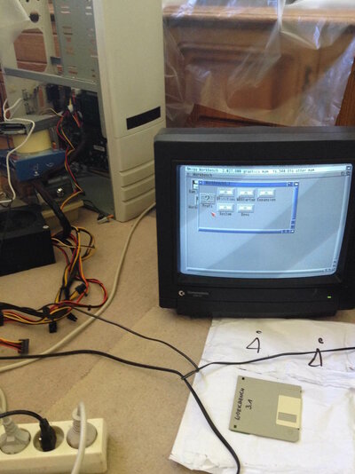

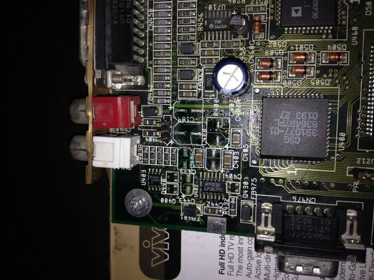

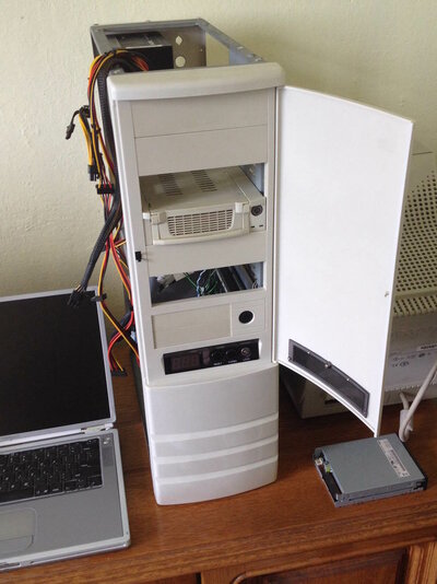

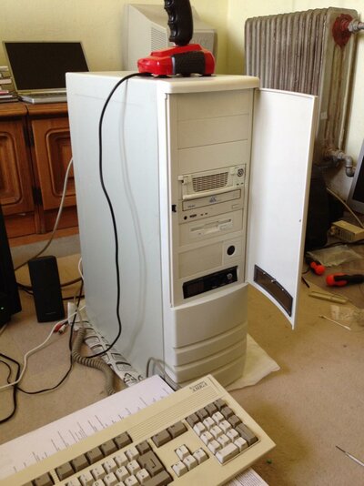

this is my new and last Amiga computer project , short history of this Amiga 4000 , I bought this comp from my friend from amibay site , Micronik case was total yelow , motherboard had leaky caps, burned track, sound not working and other nasty thing , I restored case with retrobright , cleaned mobo changed new capacitors , after hard work this computer back to life I think for long life :-)
this is my last project with Amiga be cause I have no time and to much Amiga system

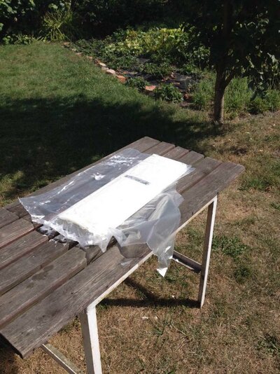

he he "GARDEN RETROBRIGHT"

If you have time, you might want to check under the LM347...I've had a couple of boards where the acid made its way under the chip and damaged traces, from memory there is at least one trace underneath. Alternatively, maybe some lemon juice as a precaution? Looking good so far!
