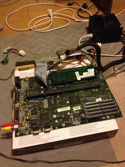

Hi i have problem with sound in my third backup mobo 4000
all caps replace , audio area look very good
sound exist but is very very low and I hear hard disk drive and fan in loudspeaker
transistor mpf102 replaced too and nothing !!
what can I do ? new lf347m ?

Probably a problem either in the U402, U403 or supporting components or traces. Do the traces and components around that area have corrosion? Can you post a picture?
But first better verify the voltages as hooverphonique suggested.

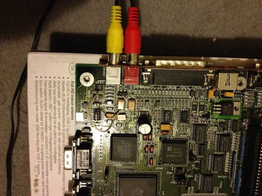

corrosion very little ! cleaned with izo , traces look great I checked with multimeter , atx give -11.30v on A4000d psu conector , are you suspect lf347m and lm8333?

Check the voltages of each pin of the U402. They all should be around +2.5V except +12V on pin 4 and -12V on pin 11.

hurrraa problem repaired !!! !!! there was problem with track corrosion ! thank you HESE
and thank this http://www.amigapcb.org
PCB website for many hours with lupe and solder machine ! I found one small problem fast connect jumper with wire and sound is great !! amazing :p
