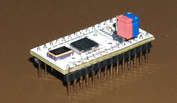

Some people wondered about the jumper settings so here it is:
If you hold the board vertically as the pin 1 is up-left
- upper (blue) jumper - close if installed in motherboards designed for 8580 / open if installed in place of 6581 (output attenuator)
- lower (red) jumper - close for 6581 mode filter / open for 8580 mode filter
