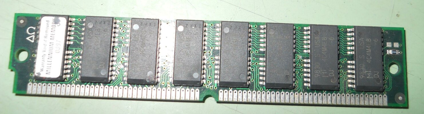

MrFrench New member Joined Oct 21, 2018 Posts 5 Country USA Region AR Nov 3, 2018 #1 Can anyone identify size of this ram: It has chips on both sides.
SaviorX VCCUG Banned Joined Jul 12, 2010 Posts 1,862 Country Canada Region Calgary, Alberta Nov 3, 2018 #2 the chips are Micron Technology DRAM CMOS 4Mbit x 4 = 16Mbit = 2Mbyte per chip = 16x2MByte = 32MByte E8=2K refresh EDO @ 60ns 32MB EDO 72-pin RAM @ 60ns Last edited: Nov 3, 2018
MrFrench New member Joined Oct 21, 2018 Posts 5 Country USA Region AR Nov 3, 2018 #3 will these work in a cyberstorm mkiii?
