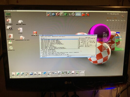

Need help with Village Tronic Concierto. No sound except for a low startup noise on power up.

So, I am in the midst of finishing up my Micronik A4000 Tower project. The following have been installed into the Micronik Tower:
Starting from the top of the Revision 5 Micronik Busboard with 7 Zorro slots.
- PicassoIV with flash ROM update 7.5. (successfully updated this tonight from 7.4). This has the Concierto sound card as well as the flicker fixer card. (flicker and RTG working with Concierto being detected)
- Phase 5 Cybervision 64/3D without a Flickerfixer card. (working)
- Triton USB with flash etc.. recently bought from 8 bit dreams on here (Working)
- Indi Computer 256MB Big RAM plus (Working)
- EMPTY
- EMPTY
- LAN-IDE-Clockport card (Working)
Mainboard is a Saft6luck Rev 2.2 upgraded ACILL A4KD with 112MB Fast RAM onboard support (128MB RAM module fitted).
Phase 5 Rev 2 060/PPC Cyberstorm with 128MB RAM + SCSI (Tested and working).
Hyperion 3.2.2 (47.111) ROMS with 3.2.2.1 Amiga OS.

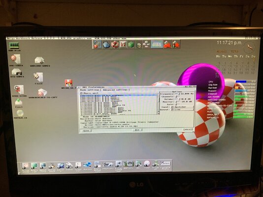

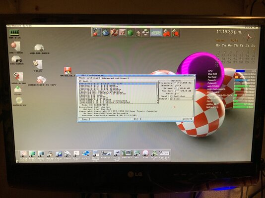

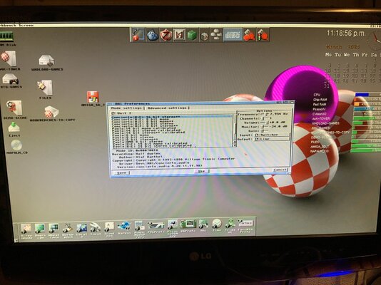

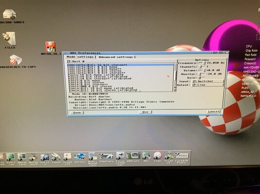

AHI Version 6.0 installed from AMINET. Pictures attached of my AHI settings.
Now the issue. No sound from the Concierto in Amiga OS. Sounds like the card is working as I can hear the startup sound. I have tried to access the early PIV flashROM menu with the SHIFT hold but that does nothing.
Have attached pics of my AHI settings.
Anyone any ideas?
Cheers 🍻

What AHI programs are you using with the sound card?
