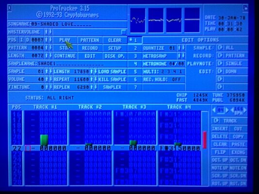

You downloaded software for the A1200, not the A600 ... an easy mistake to make if you are a beginner.
Try this ... Protracker 3.15 :)
Save the file, unzip to your Windows Desktop and copy the ADF file to your USB stick
  • PT315.zip

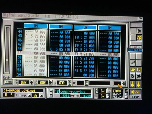

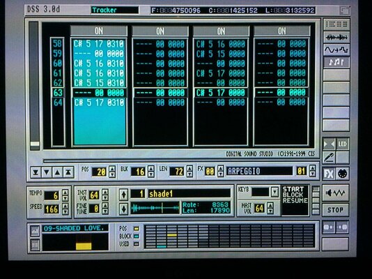

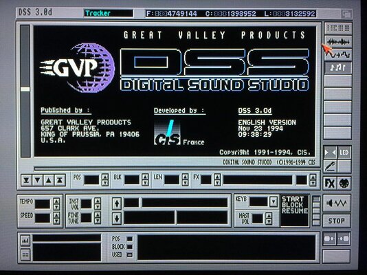

Thanks for that, I had the ProTracker but a different version, I've used the DSS before back in the day and I've loaded them up again, also an updated version of DSS which is very nice, anyway thanks so much for the help and advice, it's been a real boon, cheers
