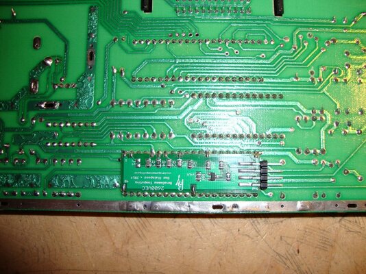

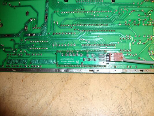

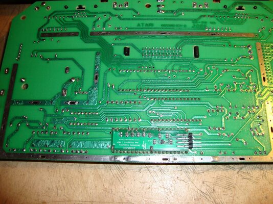

Hello Forum Chums...
I would like to introduce you to a new product available from now..
It's the Atari 2600 PureVideo module Designed and Produed by BetaGamma Computing, South Wales...
See attached piccys depicting module fitted into a Std unmodified Atari 2600 Junior...It provides Broadcast standard Composite Video and Audio via a mini 3.5mm jack...
The Module also fits ALL Varients of the 2600 Series Consoles..
Video output Pics to follow..

from the photo...is this just a simple solder to the backside of another chip? (as it appears to be)

The Design is such that the pins of the TIA chip on the solder side of the board simply solder to the pads on the module.
It is obviously designed to be compatible only with the TIA in the 2600 so any clone with the same chip should be OK.
I also believe the NTSC TIA has the same pinout but will check before I send a sample to Heather.
7800 Version maybe manufactured depending on demand.

I think the pins of the NTSC Tia are a couple I pins out. The NTSC Tia has 2 audio outputs and I think Tia 8 is moved over to the next pin. Shouldn't be too hard to route a couple of wires to get around this on NTSC consoles.
What is this board based on? I have made many av boards in the past and find on crts they look great but on newer lcds there can be some bleed. Any pics of one running?
