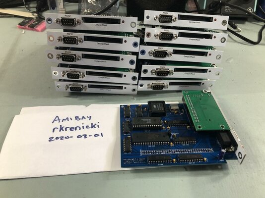

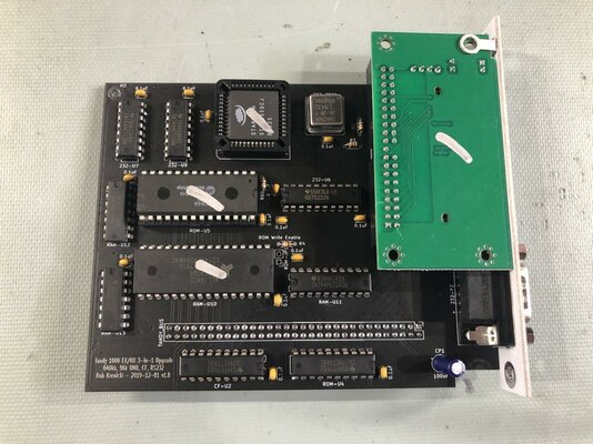

I am announcing that my Tandy 1000 EX/HX 3-in-1 Upgrade Board as complete, and I am currently assembling boards for my production run. These boards are an all-in-one upgrade solution for people who just want to play XT/Tandy era games, and it provides the following upgrades:
640kb System RAM
96kb of Upper Memory for DOS and Drivers
9-pin RS232 Serial Port for a mouse or communications
XT-CF-Lite Interface for storage
My price is $95 plus shipping and I offer some options, such as a preconfigured CF card and floppies with the UMB drivers.
As of 2020-03-02, I currently have 17 boards fully assembled, tested, and ready to ship.
If you would like to buy a pre-assembled board, please fill out the order form here: https://forms.gle/diCKK9neMXMyBziD9
If you would like to buy a bare PCB with the custom connectors and CF adapter, please fill out the order form here: https://forms.gle/qpK9ENFvUWP2UTJr7

Q: How much memory does this give me?
A: With the memory map of the Tandy 1000 EX/HX it expands the system to the maximum of 624k Conventional RAM, and also adds 96k of Upper Memory Blocks. With the supplied drivers, loading DOS 5.0 high and the Mouse Driver high, it gives you 610kb of free Conventional RAM.

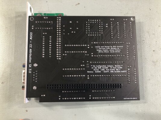

Q: Why does this not have an ISA Slot/Passthrough connector?
A: I intended the board to be the only expansion card in the system.
Q: Isn't this board "upside down"?
A: As compared to official Tandy PLUS cards, this indeed "upside down", but the CF adapter will not fit in the space below the first slot. This is part of the reason why this was designed to be the only board in the machine.
