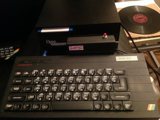

After many years of searching i have finally managed to find an almost mint Opus Discovery disk drive for the sinclair spectrum computer.
This system was the first disk drive that i ever saw in real life and i suppose it would of been in 1985 or there abouts. A friend at school was showing off that he had a disk drive (i didn't know what one was) and he had a new sinclair printer too. (thermal and he did his lines on it at school - the teacher had not seen a printed sheet from a pupil before)
Anyway here is my pride and joy...
A 1985 Opus Discovery 3.5 inch disk system for the zx spectrum.

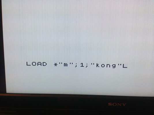

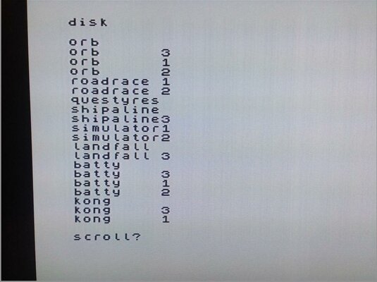

This disk drive can use the microdrive commands; i.e.
cat 1
load *"m";1;"filename"
format 1
save *"m";1;"filename" etc..
but the commands can also be shortened to
load *1;"filename"

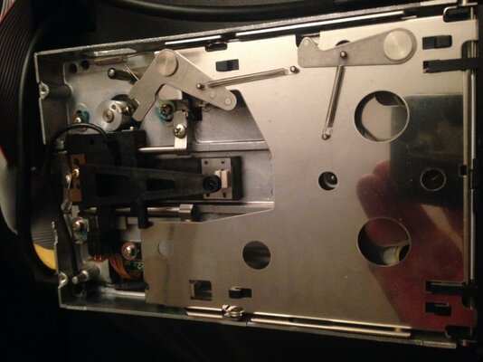

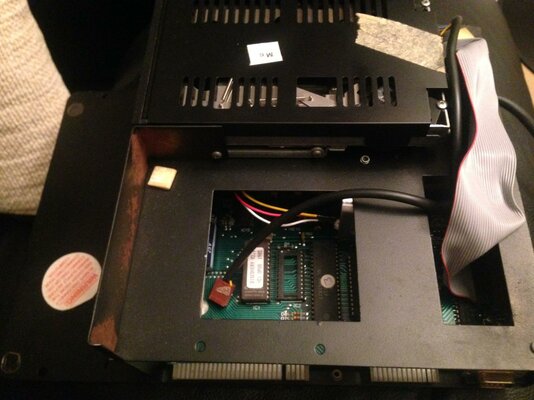

The Opus Discovery provides several different expansions in a single unit, featuring a Joystick port, pass-through expansion connector, parallel printer port, a composite video/monitor output and a single 3.5in disk drive that supports disks of up to 250K in capacity (178K when formatted).
An upgraded model, the Discovery 2, was also introduced that featured 2 drives. The Discovery 1 could be upgraded to the Discovery 2 by returning the system to the manufacturer. The power supply for the Opus replaces the original Sinclair model, and is used to power both the interface and the computer.
