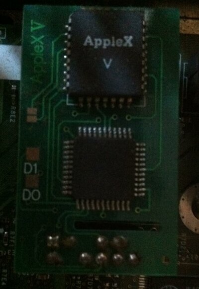

Hello iv just bought a 2nd hand original Xbox from a mate of a mate, has been in storage for a long time . Powered on fine to a slayers boot screen.
* the original hard drive is still installed ( with it having this mod chip installed is it easier to add a bigger hard drive? )
* think I need more software installed to add a hard drive so -
* iv tried burning an Iso disk cd and DVD of slayer software from my pc ( no disks will recognise )
Any help would be appreciated. I kno someone ( or some people ) here knows there stuff.

Hi Chris
Having a Mod Chip does make it easier to install a bigger hard drive because the Hard Drive does not need to be locked to the X Box like a soft mod does.
Trying googling AID 4.5 Xbox Install Disc as it will cater for Hard and Soft Modded Xbox's and has a version of XBMC on the Disc.
If you are having trouble with DVR's being read it could be the DVD drive installed in your XBox
Phillips were fine but Thompson's could be a royal pain to read DVR's
Hope this helps :thumbsup:

Seen a picture somewhere of my mod chip that has 2 wires coming off it , mine is without theese 2 wires ! I can't find any info on it though.

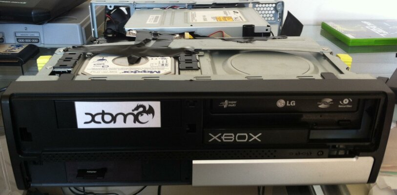

Aparently it is possible to connect an old pc DVD drive -
http://www.xbox-scene.com/articles/dvddrive.php
I will have to give it a shot !

I've messed about trial and error trying to get the pc DVD drive to work and YES !!!?
I have slayers evox auto installer working
Now what lol
Now got original DVD drive in the back and pc DVD in the front a200gb hard drive installed , fitted in pc media case, starting to install stuff , looking good.
Sd memory card slot installed , extra fan , blue LEDs .
