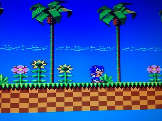

Just bought an RGB cable for my Sega Master System and was disappointed that I'm getting pattering on the image like this:
My SNES also does this on RGB as does my C64 when plugged in via S-Video.
The patterning is too regular and static to be video interference. In the past I've tried larger resisters in the cable but they only make the picture dimmer, the pattern is always there.
As this is now the 3rd device where I have this happening (RGB on the SNES and SMS and S-Video on the C64) I really want to try and get it solved.
My Megadrive, Amiga, Amstrad CPC, Spectrum and Dreamcast all use the same RGB input flawlessly. My Saturn works just about satisfactorily.
As I say I don't think it's the cables because interference to an analogue video signal wouldn't be so regular, static, and well defined. My suspicion is there's something the upscaler in the TV doesn't like.
Anyone come across this before? Any ideas?

I've been reading a lot of such threads on various forums and the usual thing that crops up is blaming the cable. I don't believe it is in this case. I think it's the upscaler in the TV. The pattern is just too regular.
We have 2 Samsungs of a similar age. Both show the patterning and the worst colour for it is blue. If the screen is scrolling left or right the patterning disappears only to return when the screen is static again.
When the screen is static in Sonic, if an object moves over the blue background, the object leaves a pattern free area for a fraction of a second.

Have done some investigations this weekend. A 100 Ohm resister on the composite line of the SMS's SCART cable greatly reduces the patterning. Tried a 150 Ohm but as the TV derives the sync from the composite signal you start to see line jitter.
However it also appears to be the case there is a grounding issue somewhere.
Tried the same thing with the SNES. 950 Ohms on the composite line gives the greatest reduction in patterning. Taking it to 1K cuts the picture totally. But again there appears to be a grounding issue.
Conclusion is that both cables are a bit rubbish and need replacing. However at least I have an RGB connection on the SMS that gives a satisfactory if not perfect picture now. Before it was unusable.
The SNES is usable and better than composite but the patterning is still quite evident.

Sorry to drag up an old thread but I have useful info.
The interference did indeed seem to be coming from the composite line where the RGB was deriving it's sync from. The larger resistance I added to the line the more the effect reduced but also the video started to become unstable.
I managed to find a company selling cables that offered sync without the composite signal being present. Cable arrived today and this is the result:
The company I used was called Retro Gaming Cables and it was their Megadrive 1 cable (mono) with composite sync that did the trick.
