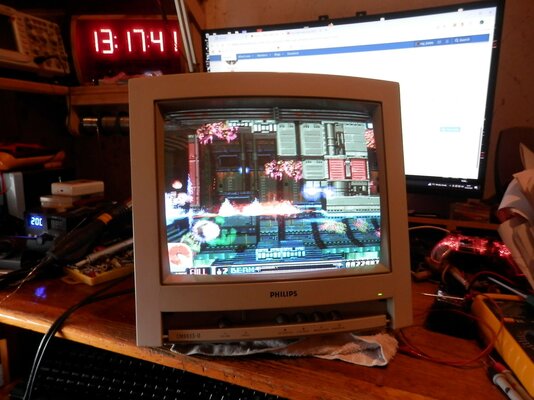

Hi all, looking to see if there is anyone local who will do repairs on a couple of Amiga monitors I have?
First one is a CM8833 MK2 - It works and I have used it for quite a long time, but it has some little oddities.
The power switch as expected can be flakey and has to be stuck down to keep power going to it.
If the audio is too high, 1 of the speakers seems to cut out.
Sometimes I get a quick white noise like noise from the speakers and the screen "wobbles" out for a moment like it just had to correct itself.
Not sure if this down to a component failing, caps needing replacing or dry solder joints. Not confident in opening up a CRT to look myself so hoping there is someone out there!

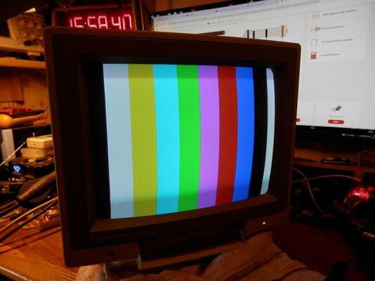

The other monitor is a Commodore 1084ST - came with an Amiga I bought recently, and plugging it in and turning it on - nothing at all, not even the power light on the front, no life in it whatsoever. So hoping this could be looked at too.

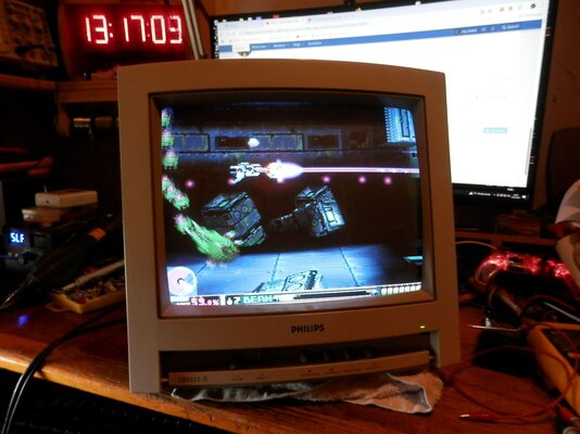

first off i gave it a clean inside,it was very dusty,then reflowed all the joints that looked cracked,all the input connectors,and around the lopt pins were cracked
i replaced the mains switch,it had failed,thats par for the course on these
i removed and soaked two of the front controls in ipa,they were scratchy,volume control and brightness
small psa here,this still has the original lopt installed,if it dies he is welcome to bring it back like i said while he was here im not a salesman and not here to upsell what isnt wrong unless he wants it doing,and besides there no way to tell when that would fail,sio im leaving it be,for me its not a big deal
at the moment its fine and i think i cleared the faults mentioned here
couple of pictures to show it works

right next one,the 1084st
completly dead,it was power supply failure,i replaced the tda4605 and buz90 in the supply that fixed that problem
and another problem reaer its ugly head,the controls for brightness and contrast didnt work,that was a cold solder joint in the control panel
pain in the arse to get to ,but...fixed it
picture to show it works,ill send him a pm,hope his happy
