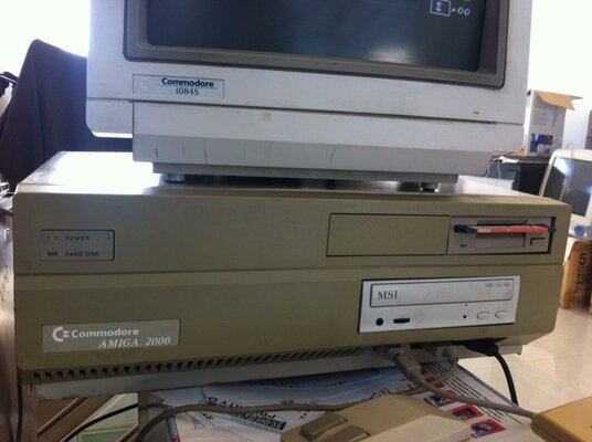

I straightened out the case, replaced the damaged front panel/bezel, cleaned it up, got an almost new original A2000 power supply and removed those nasty pc psu wires that were attached to the bottom of the motherboard.

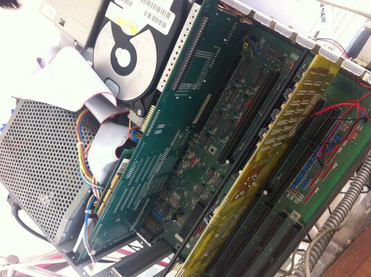

Next, I changed the chipset to ECS instead of the OCS and upgraded the kickstart to 3.1. I also replaced the 512K Agnus and did the mod to address all the onboard ram to chipram giving me 1MB chipmem :)
It still needed a hard drive controller and some fastram. It did come with a commodore 2MB expansion and an Alf2 SCSI controller but the 2MB expansion was faulty and i could not get the Alf2 controller to work. I also needed a keyboard.

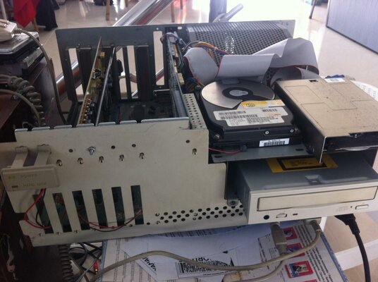

So I got myself a nice GVP HC +8 Scsi controller with 8MB Fastram and added a 1GB HD and Scsi CDROM drive. Ahhh much better now. Also got a Keyboard. Both from here of course :)

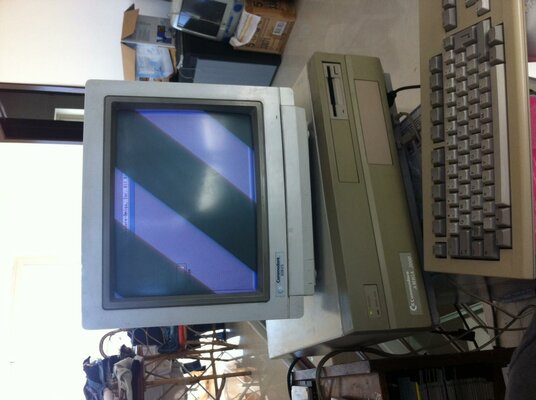

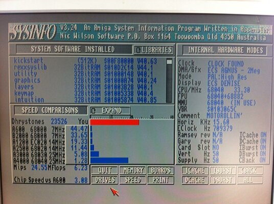

Still not content with the setup, I decided a big box Amiga is wasted without a RTG graphics card, so along came the Villagetronic Picasso II. A lovely card but pretty useless with a 7Mhz 68000.

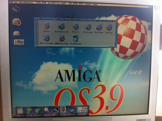

So, I needed a CPU upgrade. Part exchanged a spare A600 for a Commodore A2630 for a nice 25Mhz '030 boost. Now I was able to install OS3.9 and some goodies. I also managed to install Picasso '96 and finally had a decent RTG enabled Amiga again.
I then bought a GBS-8220 Scandoubler / Flickerfixer which works really well especially with the Picasso II's autoswitch.
I wanted more though and while browsing on the other bay i found and bought a very nice GVP '040 33Mhz Scsi combo with 16MB 32Bit fast ram. Now I had an Amiga 2000 which is in many ways considerably faster than a stock '040 A4000.
What I did not have is 2MB Chipram. Well after much searching I got one from here too. A Mini Megi 2MB chipram adapter :)
The specs are pretty much as I want them now. And really not much left to do. I would like to add an IDE controller and maybe some more fastram and an HD floppy drive, maybe even an Indi ECS someday but thats about it.

The case must have been slightly misaligned in its time because the fit is 95% not 100% when it is closed up.
I need the proper screws to for the sides of the case to close it up.
The floppy drive is misaligned. Maybe because of the case or else because it is of an A500 and i don't know if it is 100% the right hight for the A2000.
I need to solder an LED for the floppy drive. I have an LED, I just have not gotten round to soldering it.

Upgraded Kickstart & OS to 3.1
Upgraded Agnus to a 8372 PAL 1MB ECS Agnus (Well it was NTSC but i cut/opened the J102 to force PAL)
Did the mod to get 1MB Chipram - I now have 1MB Chip & 8MB Fast Yayyyy!
I did not even know there was 512K fast ram hidden and not being used on the board. I can also confirm the board is a Rev 4.4

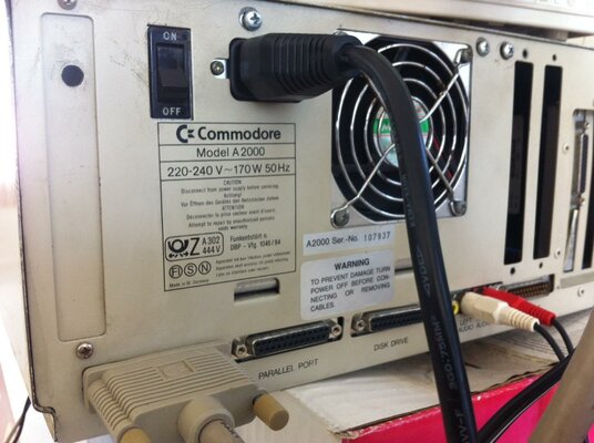

so its the back 3 covers ya missing I can see now on the pics :)
must admit I like my 040 A2000 over the o4o A4000 for some reason 2
An 040 on the A2000 is more impressive than it is on the A4000 that's probably why.
Well i'm missing 2 back covers. The other one has a hole in it. Probably the previous owner had some switch there.

Which accelerator card are you running? Mine could do with some extra power :)
Thanks :)
I am now waiting for my Megi Chip and it will be 2MB Chipram
Just 2 months ago it was with 512K chip / 512K fast, 68000, no hard drive and no keyboard. LOL
