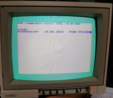

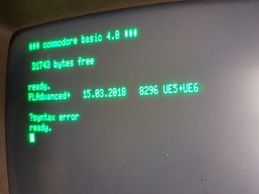

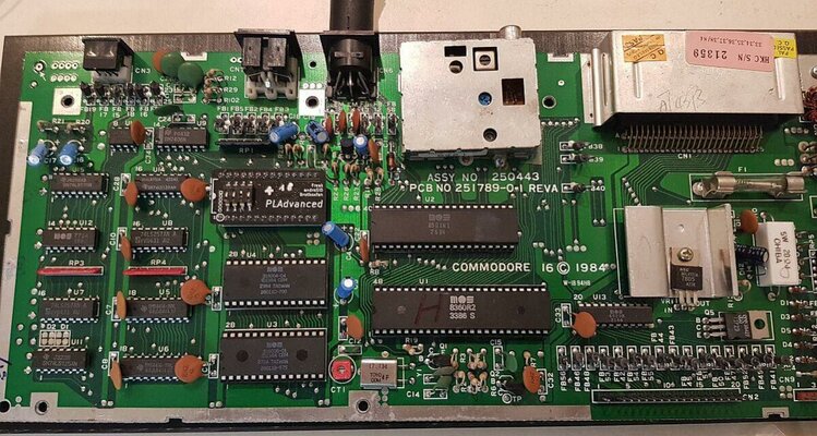

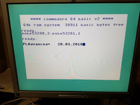

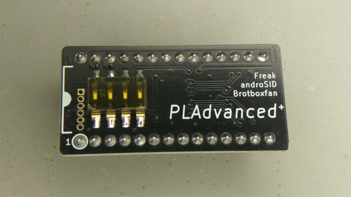

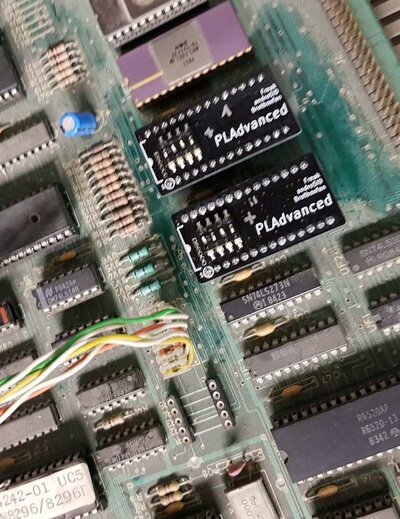

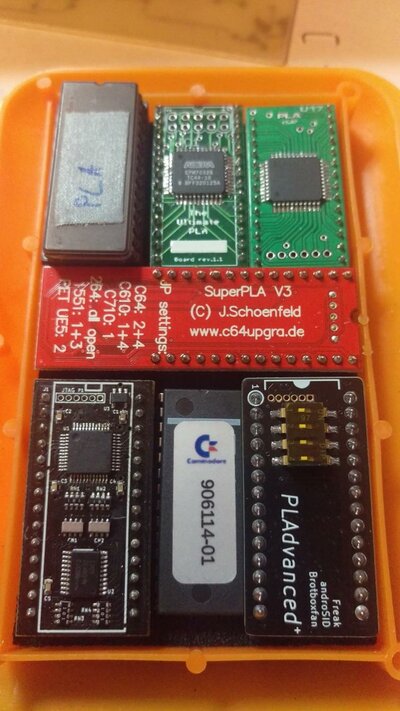

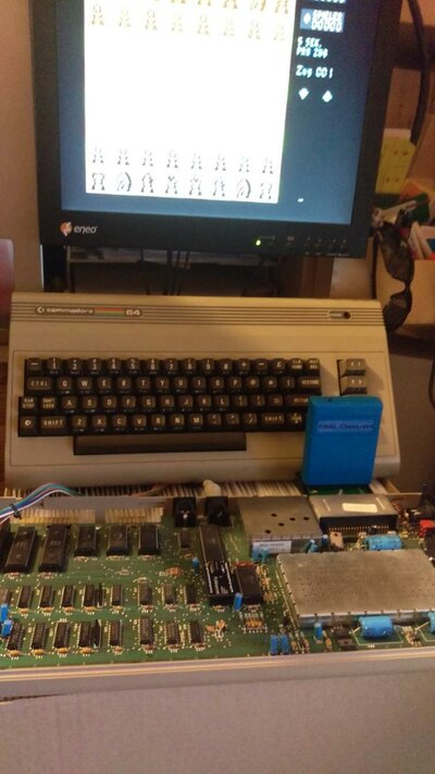

As it's getting more difficult to find the right spare parts we (Freak, androSID and I)
thought we might build something for our stock of spare parts:
PLAdvanced(+)
This new PLA combines up to 9 different 28 pin PLA from C= machines in one:
  • C64 / SX64 (no 250496 Board)
  • 1551
  • CBM 6x0
  • CBM 7x0
  • C16 / plus4
  • CBM 8296 UE5
  • CBM 8296 UE6
  • P500 U78
  • P500 U88
Configuration will be done via solder joints or via DIP-switches.
So you don't need to keep several PLA but just one!
PLAdvanced+ with DIP- switches
This is the small version PLAdvanced including 4 PLAs to show the solder joints

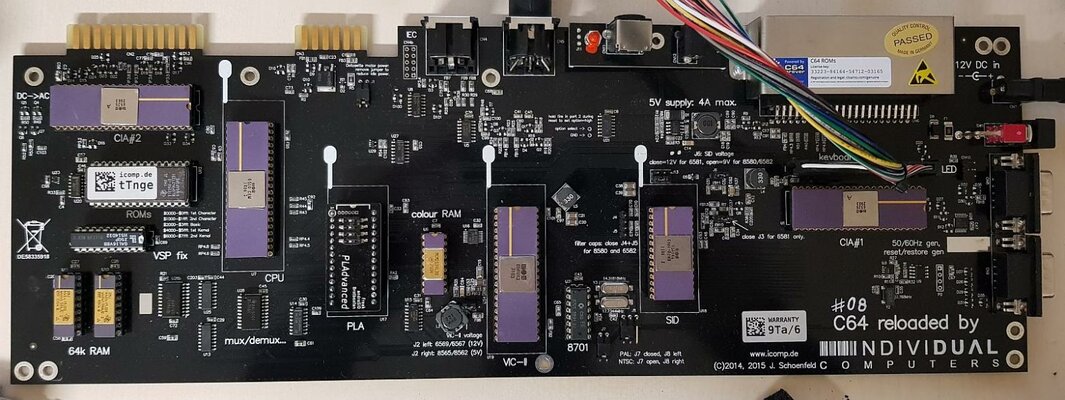

I'm glad to see somebody else used my 74LS279 PLA tester circuit.
However, I have to indicate PLAdvanced does not appear to have the proper CASRAM latency required for C64 boards 326298, KU-14194 and early versions of the 250407.
AFAIK, only these c64 boards have specific requirements for latency on one of the PLA output for proper DRAM access.
AFAIK, Other Commodore 8 bit products which use the PLA have no such requirements so PLAdvanced should work with everything else.
What did you do to come to this conclusion? Did you actually measure the CASRAM# latency or is this just guessing?
Or maybe you got your hands on one of the early prototypes because I cannot recall that you bought
the final PLAdvanced officially? :D
Apart from that we've measured the latency on several revisions of the C64 board (up to C64R) and the latency
was always in the same ballpark as all PLAs supplied by C= we've had at hand (early ceramic 93459, 82S100, PLS100, 251064-01
and of course "standard" 906114-01 with either 7700 or 8700 silicon die in it.).
That means: PLAdvanced is neither worse nor better than your Plankton... it's just more versatile and worthwhile than Plankton. :cool:
Developing a PLA replacement is NOT rocket science! :thumbsup2: Everyone can do that.
In other words: Should we ever face an incompatibility we'll address that of course...
BTW: We've even reduced the voltage at the outputs from PLAdvanced to ~4,2Volt to simulate the original PLAs from C= (~3,8V-4,3V).
I did not see that on other PLAs! Most other (pure) CPLD-based are limited to ~3,3Volt at their outputs (except when using some excess voltage

The CASRAM latency on genuine Commodore PLAs varies from 28ns to 40ns. It's a pretty wide range. Same ballpark?
I saw this with Mytec's PLAtinum and the SuperPLA... :roll:
