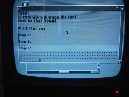

So during this week my PPC card started playing up , no display , no menu and no booting from HDD.
after spending hours changing the power pack , reseating ram , cleaning connections i gave up and reached for my flash upgrade floppy disk.
I held down S to disable SCSI and turned on the amiga and waited for the floppy to boot in to a workbench screen.
i clicked on the BPPC060upgrade icon and away it went BUT ....very slowly , usually it take 10 or 15 seconds this took minutes.....
and then it rebooted to a blank screen , no boot no logo - a flickering screen.
And the PPC card would not boot the Amiga.
i have spent hours trying to get it to boot but no nothing , well today i thought i wonder if the ACA500 would boot and allow an upgrade?
well yes and no ... the A500+ booted in the ACA menu and i can see the 060 card
- result!
but when trying to flash i get the ERROR - PPC 603e found , 0mhz no clock speed , SET clock speed or something like that ????
well after searching for hours on the internet and most people saying use the FORCE command , i eventually found this after trail and error.
add this to the icon command when it pops up...... BPPC060upgrade 240 mhz
or what ever speed your card is , 300mhz or 160mhz or what ever , im not sure if i added the space between 240 and mhz.
this then started a slow PPC update on and Amiga A500 ...it takes a good ten mins - be patient.
it will say
UNLOCK FLASH
STAGE A.....
STAGE B....
STAGE C..............
DONE.
and all working in the 1200 again
mike.
