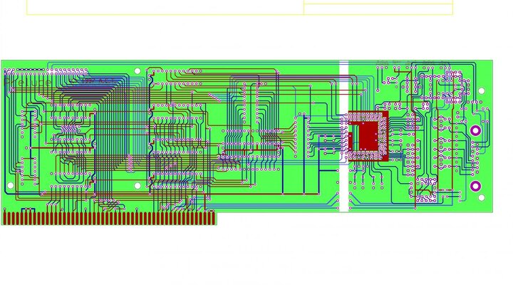

Hi!
I managed to make the prelude PCB design . I think it's one of the most interesting sound cards on Amiga. Is there any interest in reproducing this?

Sure but are you talking about just the PCB or entire card including the CPLDs?

The code for CPLDs is available, I designed the pcb again.
There are still some tweaks to do, the next step would be using a single and larger cpld, smd components and reduce the size of the board , due to pcb price.

What would be kickin rad would be to make it half size so it could fit inline with a PCI slot, also put the audio out as the standard header like you would find on a PC board for front panel audio. And include CD audio style headers so you could route the Mixer-Out to A4000 CD-Audio in on the motherboard.

I decided to get back on this. Schematic is being made. As soon as I have I will try to simplify the board with a fpga or a cpld to remove most of the logic around. Main objective is to make a smaller board , therefore making it a bit cheaper.

I humbly suggest that you identify why the prelude with mpeg it plays mp3's slow. I loose about 35 seconds a song with a fully loaded 3000 with an 060. Another Amiga use tested his prelude on a decked out 4000 with identical results. Such a great card, to bad it has such a major defect.
