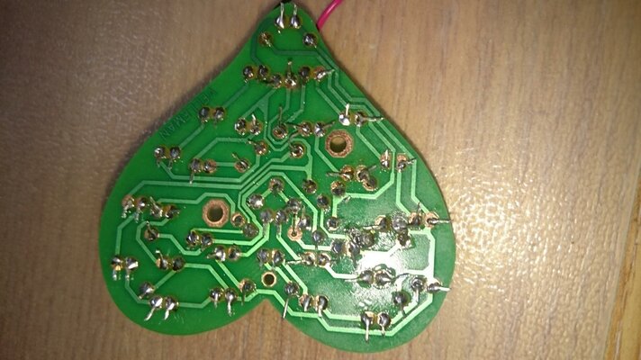

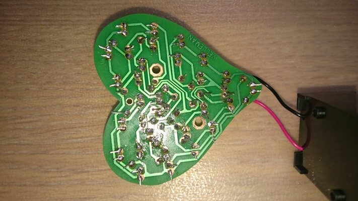

Greetings fine, assembled Gurus, Genii and gentlefolk. I present for your viewing pleasure my first ever completed electronics project. Assembled from parts in a meagre ten hours, this incredible device will mesmerise you with its blinking lights and, er, blinking lights. Pictures at the end (yes, I'll make you read my cr@p before you get to the good bit.)
I bought this silly little set because, other than a couple of simple Spectrum RF bypasses, I'd not picked up an iron in over 20 years. I wanted something inexpensive and with a lot of points to solder and this kit fit the bill nicely. My question, however, is thus: (and I realise it's a doozy)

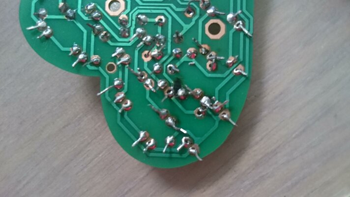

What am I doing wrong?! IF you take a real close look, anyone with a clue what they are doing would deem at least half of those joins as "bad" or at least "in need of re-flow" and some of them are downright awful. Though, I am compelled to point out that other than a couple of the LEDS, it worked first try. They were easily fixed in a matter of seconds and we were good. But seriously, I'm obviously doing something wrong - some of those points took a nice "correct" blob of solder in a few seconds, some of them did so after much longer and the ones you can see are really bad, just wouldn't. I know it's me, but I don't know what I'm doing wrong. I've tried ensuring I heat both the pad and the leg, as well as one and the other independently. My hazy memory tells me you need to do both though, which is what I did in most cases.
Tinning - the tip of my iron, I came to suspect towards the end, may be part of the problem. I can't seem to get the very point of it nice and shiny. Does it need a new one? The rest of the tip comes up nice, but the last couple of mm (ie the part usually in contact with the work) will not. Is this the problem? is there a solution?
I do know I need some better snips, the legs are pretty messy but this was the best I can do with what I had to hand. Seriously, any feedback, tips or suggestions would be appreciated. I'm going to look into buying another project kit for more practice. Does anyone know any simple retro computing kits? Really simple? I'm thinking sinclair joystick interface levels of complexity, max.

1) Temperature:
Seconds = VCC, signal lanes (not much copper)
Long period of time = GND plane (thick copper? or w.e ) not enough heat, get better iron, or hold it for longer before applying solder, tin the tip first, possibly introduce some flux to the through-holes where it is obviously gnd plane before holding it down as your flux probably burned away before it got hot enough.
2) Solder: Cheap solder from china, terrible and hard to flow bad combination of fake or wrong mixture of elements. I recommend going for anything around 60% tin / 40% lead from reputable seller (not flea bay) (Rs-Online, Digikey.co.uk, Farnell...). Some cheap Silverline brand works great but also use 40/60 Felder lottechnik 3.5% flux solder +183°C Melting Point 0.5mm 1047432 product code on RS for fine pitch stuff.
3) Method: apply iron to leg/through-hole pad at same time, after which while holding down apply solder. and pull solder away once filled. Pull iron away 2-3 seconds after.
Little newbie story (we all start at the bottom, some have good teachers, some learn mistakes as they go on) :
When I first started soldering, I applied the solder first to the tip (this is a no no except in some circumstances where you want to tack down a IC and only have 1 hand to hold it and another to apply solder iron), as i progressed another mistake I started to make before my Dad rightly corrected me was that I was applying the solder & tip at the same time, this is WRONG and a common mistake because in this circumstance you are melting solder ontop of the hole/leg but not properly soldering it through the hole which is cold, leading to a cold joint or poor connection later on.
Look forward to an update with the above 3 taken into respect.
There are plenty of soldering tutorials on youtube.
Get some good quality solder with resin core. Make sure the tip is in good condition and that your soldering iron can get hot enough.
I could be wrong but... this is usually what happens when you try to 'deposit' the solder instead of doing real soldering.
Explanation:
Sometimes, people who solder for the first time think what they have to do is put the solder on the tip of the iron then 'deposit' it at the point of soldering. That's not soldering and it can't work properly because solder has flux inside it which prevents oxygen from getting in the mix but it's effect lasts only 2 or 3 seconds.
The correct way to solder is to put a very tiny amount of solder on the tip (perhaps 1mm cube or one microliter) to make sure heat transfers well to the point you're going to solder, apply the tip of the iron to that point then very slowly add solder to that heated point. Both hands are needed...
