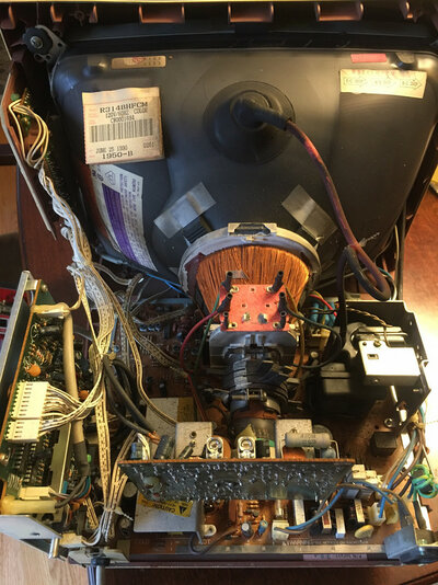

I have quite unused 1950 monitor. I noticed, that sometimes it is out of sync (the image keeps moving), but when you will reinsert a plug into amiga, the image will be steady.
Also, if it is steady, the image is with wrong colors (too much blue).
Do anybady has any experiance with repairing such issue in 1950?

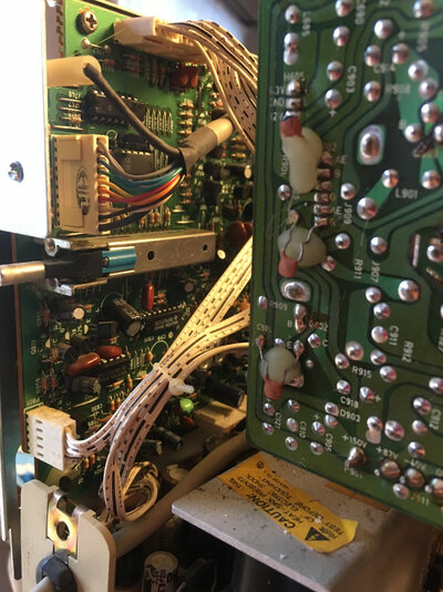

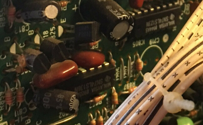

A sync problem may be caused by the monitor detecting sync on the Green input and then disabling the horizontal and vertical sync inputs. Removing the 10K R854 resistor or the 10uf C812 capacitor on the small vertical board may fix this. It may also cause problems of its own, so be warned. The analog/TTL switch appears to be prone to failure. However, if switching the switch brings back the picture, it may actually be that the 74LS123 (IC805) on the same board is failing. The suggested course of action is to replace (or at least resolder) this chip first, since it's a commonly available part. A defect in the way the 74LS123 is mounted may be present; there should be +5V on pin 3, but the way the chip is mounted or the board is manufactured, it may be intermittent. There should be a PCB trace between pin 3 and pin 16, however, pin 3 is not soldered to this trace, but only friction-fit (non-plated-through holes?). When the analog switch is moved, it causes intermittent contact between pin 3 and the trace. A soldered jumper to pin 16 is an easy way to fix this, or you may be able to solder to the trace already present. Another common problem is the failure of a multifunction sync chip. Replacements should be available from Sony. The high-voltage boards may crack; this can be one cause of the monitor that starts working when you hit it. A 1 megohm resistor in the second power supply's startup circuit goes bad, causing the monitor to remain dark. Replacing the resistor with a higher wattage one may help prevent
So soldering pin 3 to pin 16 on the 74LS123 should help?
Where is that chip located?
Is there internal color adjusting device inside of the case?

according to the service manual,IC805 is on the signal input board the one witht he slide switch i mentioned
before you do anything,type here what that ic has written on it 74lsxxx,where xxx is the last three numbers,do you understand?
there will probably be a location for that ic on the board
type the number,ill confirm

I don't see any color adjusters inside.

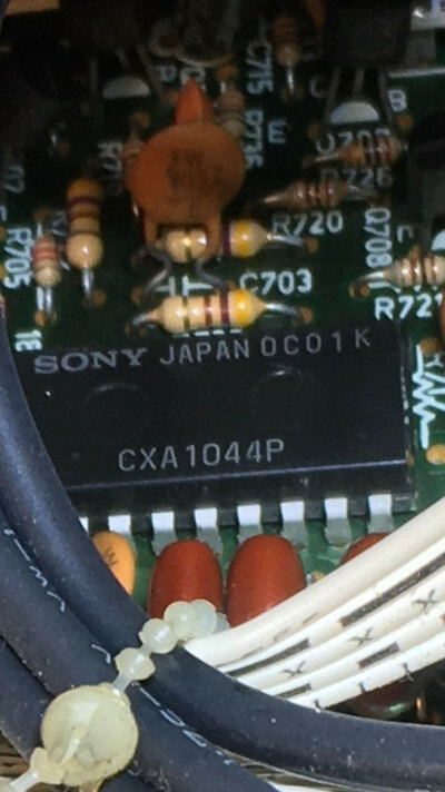

I don't see a chip you mentioned, instead I fpund Sony chip, so maybe it was replaced?

@Niezgodka Before you can even think about removing the mainboard, you will need to discharge it first, do you know how to do that?
it wasnt replaced you simply arnt looking in the right place,its under the switch on the board thats vertical,i can see it

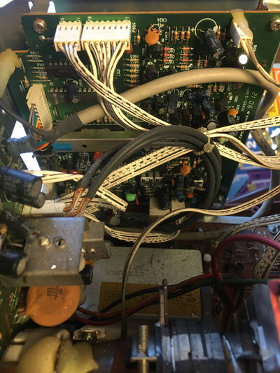

to adjust the coluor levels ,its on the neck board,i seriously think you shouldnt be doing this

By neck board, do you mean the board at the end of the tube, in the center on the first picture?
I did not notice any adjusters there :(
So it has to be adjusted when powered on with computer on and the mirror to see how colors changed?
