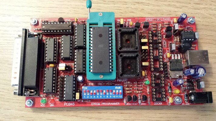

For reference here is the programmer with the eprom in the ZIF socket:
Does anyone know anything about these programmers? The problem I am having is that I can't even do a 'blank check' correctly, the software always comes back and says 'Device is NOT empty 0x000000'. It says this even if I do a blank test without a chip in the slot! I have a feeling that I am missing a setting somewhere but I have literally tried everything I can think of.
The LEDs on the device blink when I press blank check/read/write etc, and it also passes the software's 'Hardware Check' function.
Has anyone managed to program a 27c256 in one of these before?

are you powering the programmer from an external power supply or usb?
maybe the part is either faulty,or your just doing it wrong somehow..(although i never use program once devices,for obvious reasons)

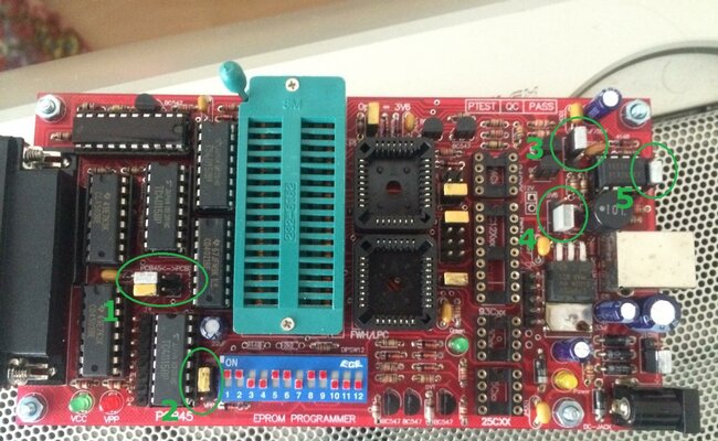

Just in case anyone else ever runs into the issue with one of these, the following is how I fixed it (purely by trial and error!)
Most of the settings are default, but the following is what worked for me and I have now programmed several of the 27c256 chips successfully!
1. Software version jumpers, my board is marked for either Willem software 4.5 or 4. I left these in the default position and made sure the software I used matched it - I later tried it with a different version and it DID NOT WORK!
2. VPP jumper. In the (poorly writted) instructions that came with my board, it advised to always leave it in the down (VPP) position. To get my chips to successfully blank check or read, I had to set the jumper to the TOP position (as in picture). When programming the chip I moved it to the BOTTOM position.
3. The manual instructs that this jumper controls the voltage when programming, along with 5. I set these to the positions advised which should be 12.75v, which as pictured is 3=UP, 5=DOWN.
4. Again in the manual it suggests settings that do not work. It says for reading and blank check that it should be down and for programming it should be up (5v6 position). This didn't work for me, and I had to leave it in the 5v position (down).
Hope this helps someone! I have managed to program the 27c256 OTP chips and I also bought some UV erasable EPROMS which also worked perfectly!

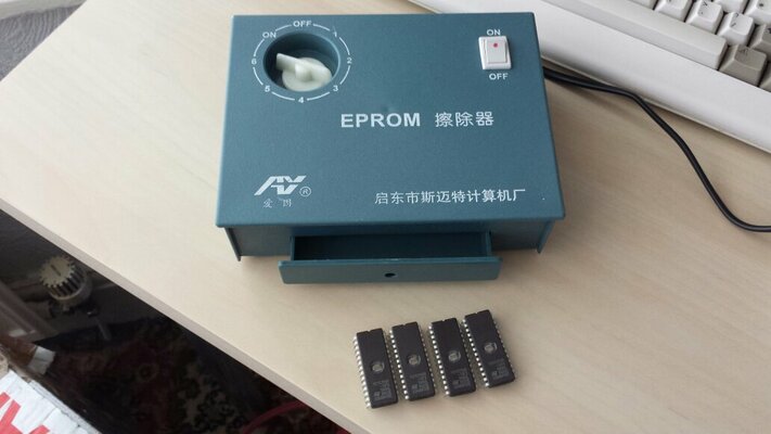

Lol that eraser looks familiar!
Yeh I got the UV eproms quite cheap so bought the eraser for future use.

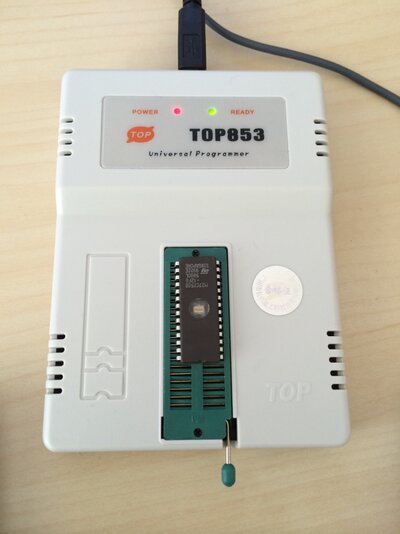

I tried several power adaptors, dont think 5v from USB can program these chips lol
Regards
Sent from my Galaxy S4 using Tapatalk 2
I was skeptical about this, but my new programmer arrived this afternoon.
Despite only running from the 5v provided by USB, this program's the 27c256 absolutely no problem!!
