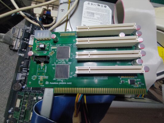

The board arrived for repair after a long wait.
One of the Xilinx chips was in short-circuit. I desoldered the chip and the short-circuit was gone.
I replaced the faulty chip with new and reprogrammed both Xilinx chips.
I also installed the missing components (PCI connector, 3.3V voltage regulator, tantalum capacitor).
The card has been tested and all PCI slots work now.
Root cause what caused the Xilinx to fail is unknown. Visually there was no sign of damage on the board.
Most likely whatever that was installed to the X301 PCI slot burned the chip.

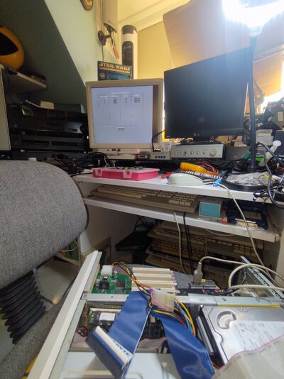

Sorry @hese I've been playing with that Acorn A3010 and neglected my Amigas

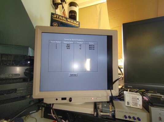

Yes the Master Builder has done it again and the card is now showing in the boot menu of its intended Amiga I've got a bit of work to do with this setup to get it all playing nice and how I am going to support the cards
but you can see it at the top of the expansion boot menu screen
