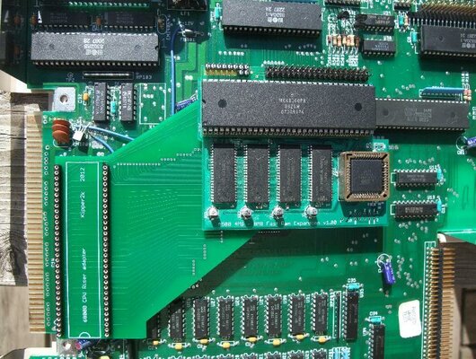

I've had a few of the IDE68k boards from MKL, they are great. Granted you really need some more system RAM with a hard drive though.
You might try to post a wanted ad for one of the CPU "extension" boards like this one...that might solve the case closing problem.
BTW, you mention Brian (Kipper2k) ignoring you.....he isn't ignoring anyone - he is so time poor with all his projects (especially the Vampire 2). I'm sure eventually he will reply, but you just have to have a long patience. Keep in mind he isn't a business!
So you are using the same IDE68k board as the poster in those pics? If so, then it looks good.
I have one of those relocation boards as well to go along with the Kipper2k fast mem expansion. I can send you a proposal DjCook if you're still interested in trying out that combo?
Hello,
thanks for Your answers dear Amigeans! my extension looks exact the same like on a first photo of the voyager_1701e.
The extension will fit underneath the keyboard if i move the piggytailed CF Reader to trapslot or where Floppy drive was placed (actually i don't like to cut my Amiga), so i don't worry about it. just want to know how long the cable can be, i think that 40cm will not make any difference..
So yes, i am still very interested, please contact me with price,

Thank You, Voyager 1701e for the pictures, and for explainig about things with Kipper, didn't knew it...

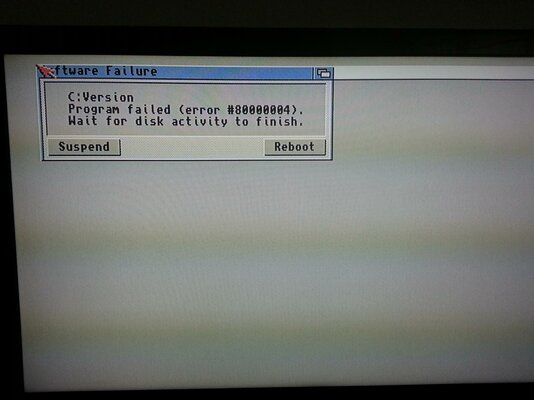

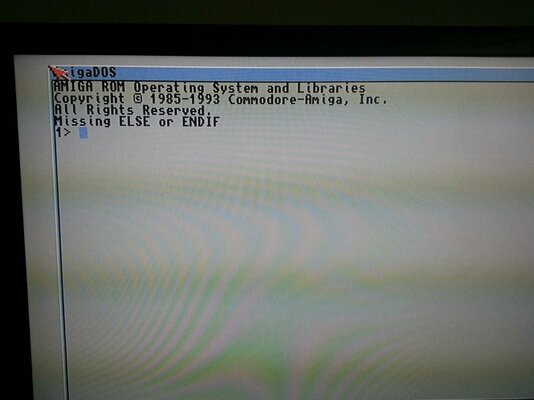

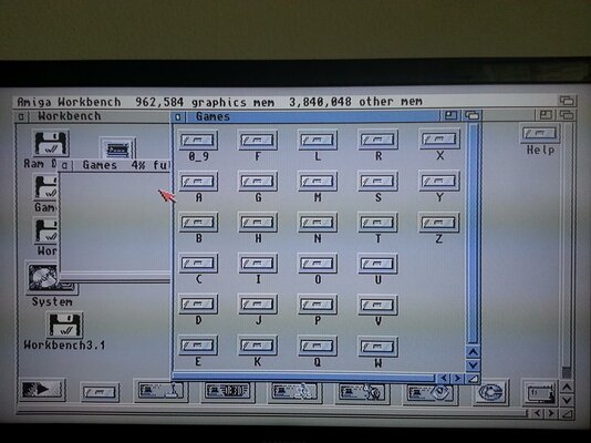

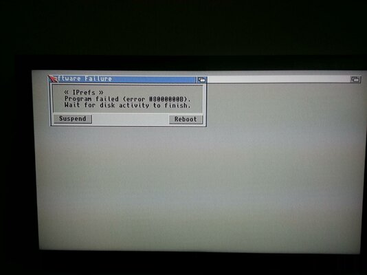

Have up and running system with mkv ide68k & kipper's 4Mb cards (without relocation board) the only problem is that i can't close the housing now so i need to think about it.

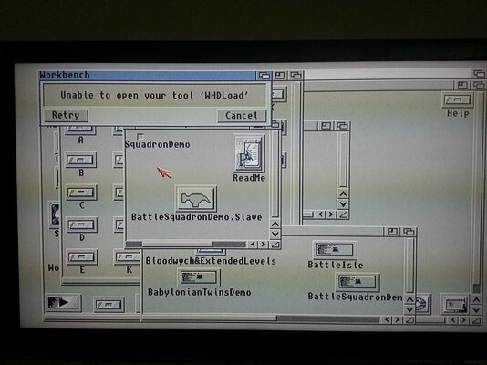

Anyway, WHDLoad just don't want to start:
WHDLoad starts if i try the CF Card with UAE, but the screen is corrupted, the WHDLoad is present in C Directory and i have reinstalled the last version 18....
EDIT 2
restarted my Miga without a gotek drive, and WHDLoad loaded! However the screen is corrupted, and the game doesen't work properly..Computer restarts after a while...
Any ideas?
EDIT 3
Finally got it running.
I can confirm that Mikes (mkv) ide68k v402 board runs in pair with Brian's (Kippers2k) 4Mb expansion board on Amiga A500 Rev. 6
I am able to run and play WHDLoad games from CF Card, however, the additional mod is necessary to convert the 512Mb trapdoor memory extension..
