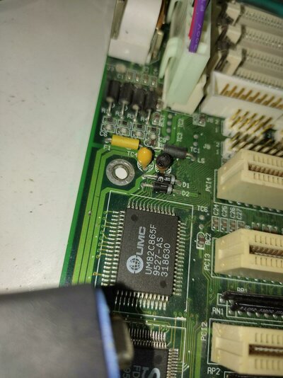

Just wanted to share with you a quick video I made today. Was looking to test some new stuff I had received and final board for the day was this ECS S54P-AIO Socket5 Motherboard. Immediately as I got it in my hands I noticed the Yellow round Tantalum caps. Usually these have the tendency to short out and pop like a firecracker. I measured with the multimeter and as expected the caps were shorted with and very low resistance. So I put the tripod and started recording the experience:
Here is a photo of the aftermath:
The board will be sent in the near future to a friend so he can recap it. Hope you learnt something
