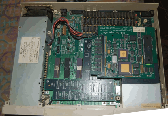

I wound up (sadly, by choice) with a wrecked A1000 and I'm slowly working through it. The package wound up including a Derringer 030 accelerator, DKB ROM switcher - it boots from a 2.04 ROM not a floppy!, and the IN1000. With all of the stacks on the CPU it arrived in pieces with 30% of the pins bent.
Do you know of anyone who has performed the IN1000 battery hack? The low priced GlitchWorks/Tindie add-on seems like a nice looking hack.
Did you ever have any memory issues? I read about the memory 'technically' not being auto-config'd. The little I've played with it has not shown any need for extra steps for the memory.
