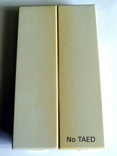

Here is a possible Australian source of a ready-made product that works like Retr0brite gel:
White King Oxy-Lift in wash liquid gel.
http://www.pental.com.au/our-brands/laundry-care/white-king
http://www.whiteking.com.au/common/pdf/White King Oxi-Lift In-Wash Liquid Gel.pdf
According to the MSDS, it contains about 8% hydrogen peroxide.
I suspect it does not contain TAED, if it did, it would most likely have a terribly short shelf life. It is a clear, blue gel, about the consistency of a 'personal' lubricant <ahem>.
I tried some last summer, on a very hot sunny day, and here is what happened:
As I suspected there may have been no TAED, I added a small quantity of an oxy-booster, (half a teaspoon, mixed with a little hot water to form a paste, and then added it to half a cup of the gel). I tried two yellowed computer blanking plates, with & without the TAED. The gel was spread on half of the plate for a before/after comparison.
I could detect no difference in effect between the two mixtures, but I should add it was a scorching hot sunny day (38C!), with extreme UV, so the TAED may have been superfluous in those conditions. But otherwise, the gel worked very well. The samples below were exposed for 90 minutes.

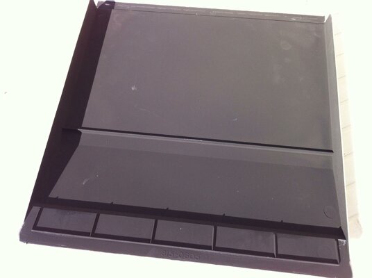

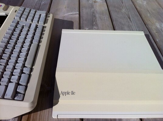

Hi
I'm about to retrobrite my apple IIe and Atari 800. Got quite a bit of ingrained dirt I can't shift from the apple case, but I see the inside
is coated in a black carbon like paint, aquadag (?) ( Or whatever it's called)
Will that survive a pretty hot dishwasher ? Pics attached. Nice bright day today so the yellowing doesn't look that bad in the sun!
My next question is re dashboard protector stuff to stop UV fading afterwards. But the 'Armor All' looks like it comes up shiny and waxy after applying. Has anyone used it and can confirm if its matt or satin, or actually as shiny and /or waxy as I fear?
cheers!
