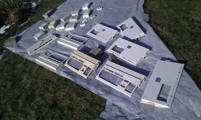

Today is big retr0bright day - I'm bleaching 4 x A1200 and few power bricks and mice. Hard to see from the before picture but one A1200 is very yellow.
I use 35% peroxide dilluted to 12%, parts is placed in the winther sun - no clouds today.
2 Questions:
1. What do you usually do with the power cords on the power supply when they are yellow too - also retr0bright?
2. I don't wanna treat my Amiga's with acrylic finish to prevent it from yellowing again. Can I use Boast wax, which also has UV filter? All my machines are in a room where the blinds are down all the time - so I guess they are not in UV light very much afterwards.
Power cords are made of PVC as it has higher fire resistance than ABS, as well as being flexible whereas ABS is usually rigid.
Discolouration of PVC cables is usually down to heat and Retr0bright won't work on this kind of effect.
You can use Armor All, a wax polish coating or an acrylic lacquer. All the coating has to do is effectively seal off the surface of the plastic from the air, preventing oxygen from re-attaching to the bromine and making the yellow colour return.

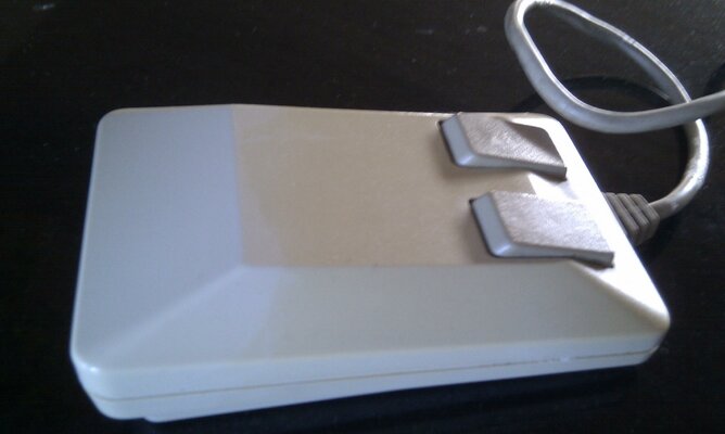

I'm trying out a new bulp today - the Repti Glo 5.0 - according to the below table and the sales guy - there's a lot of UV-A (and B) in that bulp:
There's also a Repti Glo 10.0, but i try the 5.0 to start with. More product info can be found here:
http://www.exo-terra.com/en/products/compact_fluorescent_bulbs.php
This mouse was treated on the left part only, and placed under the the bulp at 5-10 cm distance. It was there for 13 hours. The result is ok, but it needs more treatment. I stil prefer using the sun as UV-source, since it's much faster.
I'll use the bulp only, when treating small pieces (keys, mice, modulators etc.)

For the consistency, think maybe liquid soap. I coated the mouse with it and it's now under two Reptglo halogens, these are supposed to have the same UVB output as the desert sun. I'm not worried about the lamps (they turned my white shirt blue), but the mouse with the solution on it definitely doesn't shine blue like the Amiga in the pics above. Am I doing this wrong?
I've always aimed for the consistency of wallpaper paste with my formula, so that you can maybe get a film of at least 1/8" (3mm) onto the surface.
No, you aren't doing this wrong. Your white shirt that turned blue is full of a benzoxazole optical brightener that 'makes whites seem whiter' by giving off a blue UV response.
There's a smaller amount in Oxy-type laundry boosters, so you won't get anything like the same glow.
The lamps will never match natural UV light for performance, so if you are getting slow but steady results, you are doing OK.
