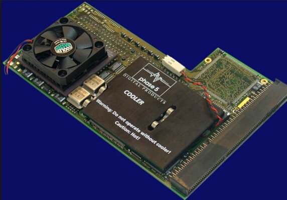

The Blizzard / phase 5 PPC is a fantastic peice of engineering. its a twin CPU , graphic ported , SCSI breathing monster of a card that was to be a step in the Amiga PowerPC evolution and with OS4 support it even had its own OS to run. users of 3.1 had to use software patches to use it but more of that later.
So lets look at the card,
Blizzard PPC
160, 200, 240 mhz & 256 MB ram , SCSI
This accelerator board was designed for Amiga 1200 and plugged into the trapdoor slot. It used a low cost, low end processor designed for portable and embedded use.
  • PowerPC 603e at 160, 200 or 240 MHz
  • 68040 at 25 MHz or 68060at 50 MHz
  • Two 72 pin SIMM sockets accepting 256 MB RAM, 32 bit wide
  • Ultra Wide SCSI controller
  • Expansion slot for the BlizzardVision PPC

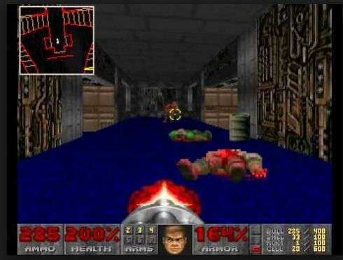

So what can it do ?
Well to be blunt , the PPC card will turbocharge your Amiga in to Pentium PC speeds like youve never seen before. To get the best form the card you will need a SCSI Hdd or a fast IDE setup as the slow IDE amiga cannot keep up and it will be a severe bottleneck. How about 256 mb ram ? not a problem but be choosy about which ram fits the sockets.
With OS3.1 the OS is still 68k so it will boot and run via the 68000 cpu and not the PPC , only OS4 does this but OS4 is a big OS and its too big for classic systems really.
WARPOS, PPC OS ?
Phase5 developed a PowerPC kernel called PowerUP which ran alongside the 68k based AmigaOS. Effectively, a programmer could then utilize the PowerPC CPU as acoprocessor. German company Haage & Partner developed a competing multi-tasking kernel called WarpOS for the phase5 PowerPC boards which operated in a similar manner but was not code-compatible with PowerUP. This lead to two different version of PPC software on the PPC amigas.
But what can it do ?
https://www.youtube.com/watch?v=vo97gPaz15A
https://www.youtube.com/watch?v=qsPrKMYpTz8
https://www.youtube.com/watch?v=6BkIiymdN0I
