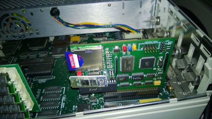

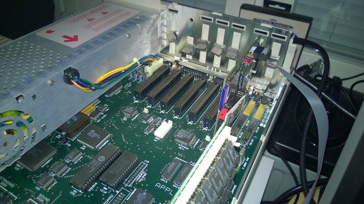

When I purchased the card, it had not been verified to work with the Apple IIGS, only with II, II+ and IIe. I decided to take a chance and get it anyway with the intention to sell it forward in case it wasn't compatible. Here is the card installed in my Apple IIGS.
The card came with an SD card that was pre-loaded with software. The card was in FDD mode by default so the IIGS booted into Tetris. I installed BlueTerm into my Nexus tablet and was able to connect to the card easily. There was a few configuration changes to be made in BlueTerm to display the contents correctly. There is a pretty good documentation that goes through the installation of the card and setting up the connection.
The mode can be changed from the terminal with a simple command and then you simply just load the image and reboot. The IIGS does indeed work in HDD mode but only with ProDos images. An image containing GSOS just failed to boot. ProDos16, which is the predecessor of GSOS will however boot. The reason to this is that the GSOS is 16 bit code whereas ProDos16 is still 8 bit code.

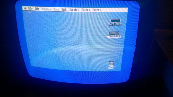

I had already contacted the seller during the purchase that the card would be going into a IIGS and that I would be glad to report my findings, if he wanted. He accepted my offer gladly. I reported my findings and to my surprise he responded that he's going to purchase a IIGS of his own and get it working with it. My surprise was even bigger as after two weeks he had a working firmware and ROM bios that I could try out.
Upgrading the firmware was a simple matter as the file just needs to be copied into the root directory of the SD card and hold two buttons on the control dial during bootup. The ROM bios on the other hand was on an EEPROM and that needed to be flashed. Luckily, I am in possession of a Willem programmer, so I was able to reflash the chip. As you can see, the GSOS now boots nicely.
GSOS boot time from powerup to desktop takes 1 min 10 sec. My GSOS installation isn't vanilla so that might add up to the booting time. Some of the other mass storage solutions for the IIGS are faster but that's not that big of a deal for me. Have to try to make a vanilla setup of GSOS to see if it makes any difference in boot time.
