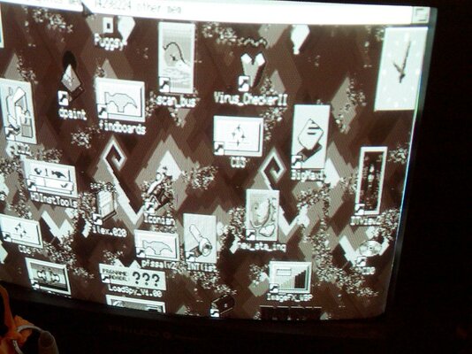

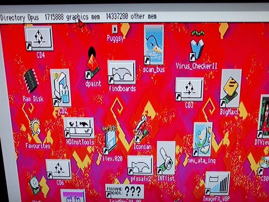

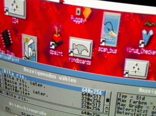

here is my last product: a card that convert the RGB signals from an Amiga RGB port to CVideo/S-Video/VGA, to make easy to connect a lot of video device.
This is not the first card of this type, but it offer something different
Follow the pictures of CVideo from this card (plugged in a plain A1200), compared to the on board CVideo of the same computer
HiRes
LowRes
SuperHiRes
The kickstart picture from an A600, with my card (on the left) and with the on board CVideo out (on the right).
The picture that come from this card has a bigger flaw of colors, but it is not so visible: it is like a little flicker on the bord of some lines, then this lines are much thin.
The picture that come from the on board CVideo of an A600/A1200 has less flaw of colors but it is much more blurred (in SuperHiRes, the image is unreadable).

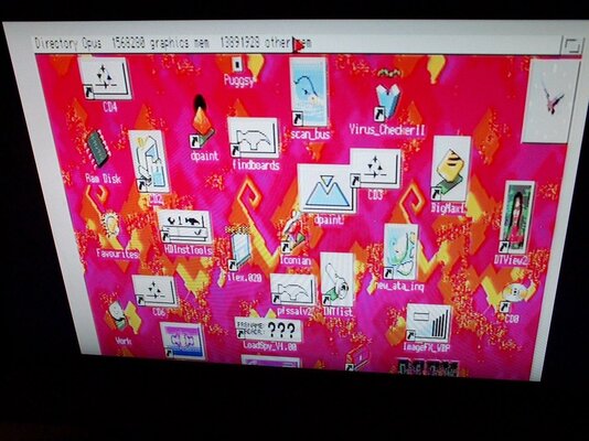

Hello,
a little update with review.
The outputs are three, always active: is responsability of the user do not damage the video device.
The output are CVideo, S-Video and VGA. This adapter is not a scandoubler, so the VGA output is active even if the signal is about 15 KHz on the horizontal sync.

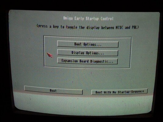

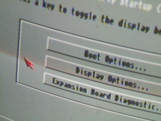

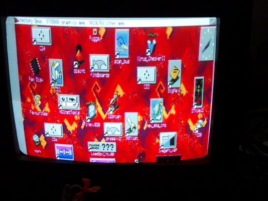

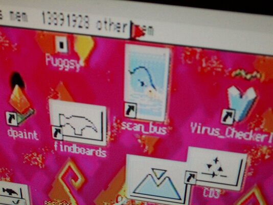

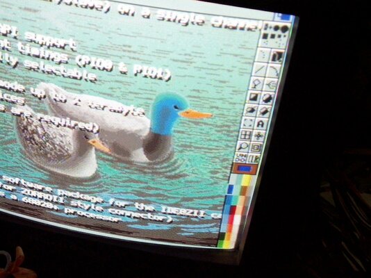

Now some pictures from a CRT monitor (with a SCART2CVideo/S-Video adapter):
the CVideo on the Early Menu screen
on a HiRes Workbench

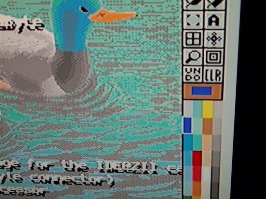

on DPaint
The image has flaws. There is a regulator on this adapter, to gain the best quality on CVideo. VGA output is not affected and it has ever the best quality.
Anyway, as already wrote, CVideo image is sharpe and clear, much better then the original CVideo output from an A600/A1200. To paint with a paint program is very easy and funny: you have just an easy cable with an RCA connector. The quality is ok!
On a Workbench screen, the characters of a text, where contiguous pixels alternate dark and white colors, give more flaws, and the quality of the image is less clear.
The S-Video on the same CRT monitor with the same adapter from a SCART connector: the monitor do not understand the S-Video input, just the luminance, and the picture is gray!
